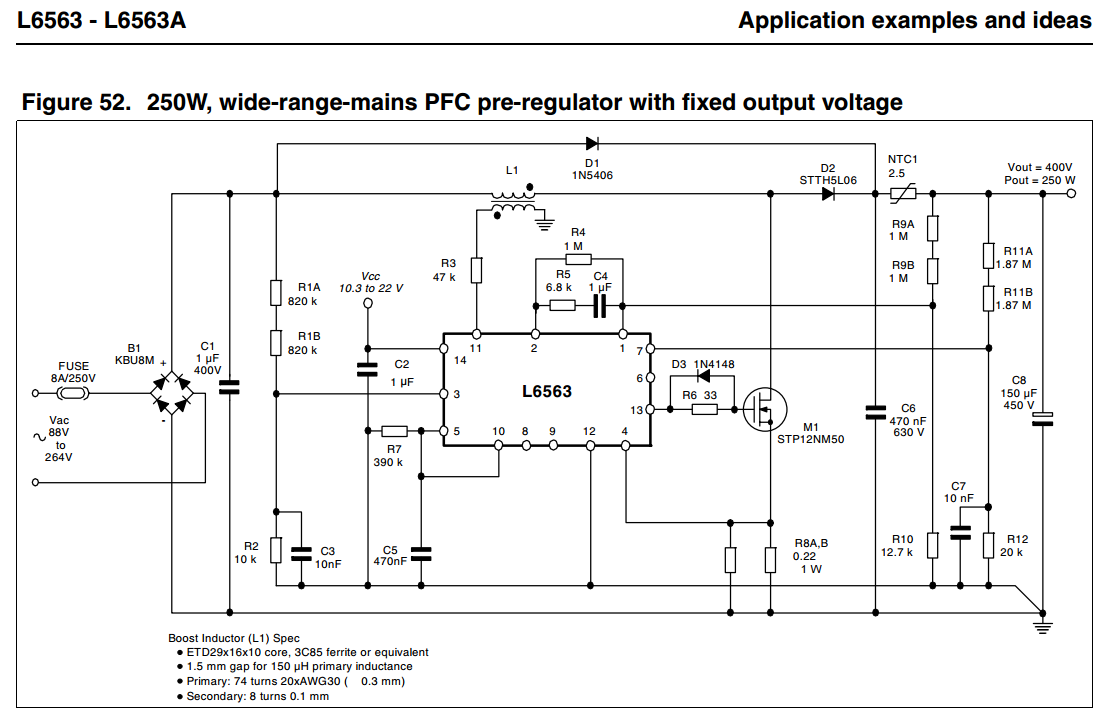

First my approache was building a flyback style circuit using the ST L6563.
The trouble with that approach is that the output voltage is 400Vdc which means I will have to build a resistive voltage divider to get rid of the extra voltage which will be a waste and will just turn it into a heater.
Try as I might I can see NO way to get the voltage down to 140Vdc using this chip using 240vAC as the input. (kind of obvious really as it is a step UP circuit ! )

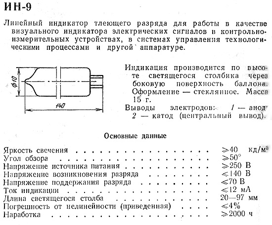

Here is the Russian data sheet.
Please save me from sitting at my computer researching for weeks instead of at my soldering bench building for months !!!

(1) It would b a great help if you could translate the Russian data sheet above for us.
(2) I am assuming that the tubes you have are gas ionizing diodes with a striking voltage and running ionizing voltage. These are generally know as cold cathode voltage regulator tubes (valves).
(3) As the deign of your power supply would depend critically on the ionizing voltage and if cant be derived from the data sheet, could you measure it and post the value on ETO.

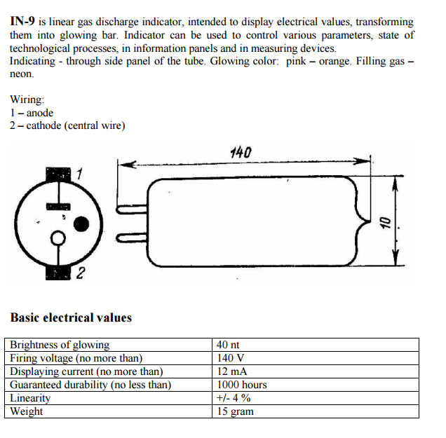

Here is a "translated" version ?
I don't speak Russian unfortunately.
But .. I can tell you from the data sheet by guessing, inference and experimenting.
B in Russian = V in English.....
Line 1 is the kandela out. 40/M2
Line 2 is the viewing angle 50 degrees
Line 3 is the maximum voltage that can be applied. 250
Line 4 is the ionizing voltage. 140V
Line 5 is the maintenance voltage. 70V
Line 6 is the maximum milliamps at which the bar is fully lit. 12mA
Line 7 is the bar length lit minimum and maximum. 20-97mm
Line 8 Linearity +/- 4%
Line 9 is possibly the lifetime of the tube ? Although the 2 data sheets seem to disagree.

These things are 140mm long, far bigger than the ones which I was thinking about.
I think that I can safely say that I have never seen anything like this before.

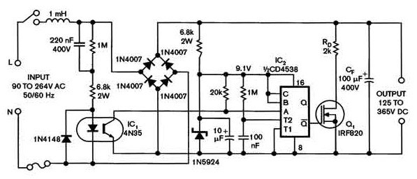

I found this very old looking circuit.
Looks kind of like a boost circuit without any inductor ! ??
Have zero clue how it holds any specific voltage. I can't see any feedback at all ?
Looks too me like it just reduces the mains then wanders around at what ever reduced voltage it feels like.
See no way to fix a voltage with it. ?
I like this circuit. But I also hate it ... because if I use 240Vac I can't reduce the voltage below that !
It is going to be tricky to build also .... switched mode power supplies aint my forte !
