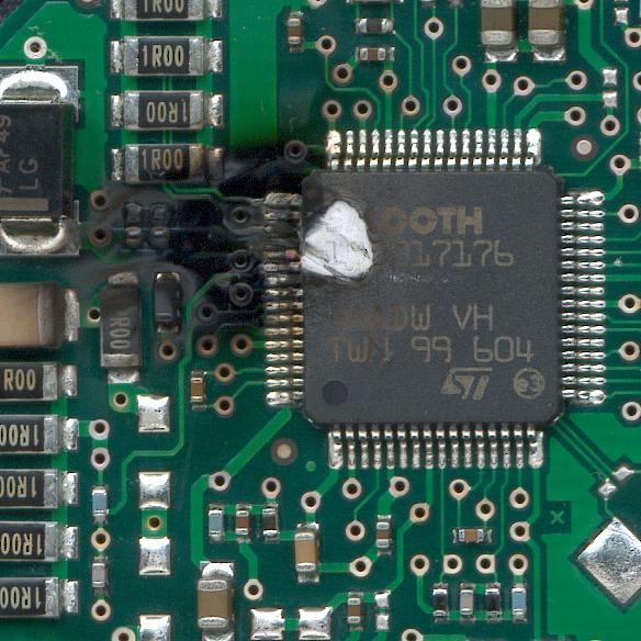

Thought you might be interested?, I just replaced a duff Seagate HDD in a Sony Hdd/DVD recorder - when I looked at the old drive:
BTW, just placed the drive on my scanner for this image.

Ooooooh....something let the magic smoke out. My condolences on your loss and may it RIP.
Really such exposures help learning . How this could have happened, any logical thought possible?
I feel, Vibrations causing a dry connection in the power feed path to the chip like the 1R00 resistor, and lack of cooling or even air circulation to the closed section where the HDD is located.
We used to service such cases, in customer premises equipment of ISDN connections.

An RDRHX725 - but the 160Gb drive size seems to be written in the firmware, and it's only showing 160Gb even with the new 320Gb drive in :(
However, it's still over £40 cheaper than getting the correct replacement drive from Sony.
