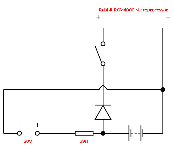

Could someone have a look at the circuit diagram I've posted and point out any problems / make suggestions? Please bear in mind this is the first circuit diagram I've drawn since I was in school :eek: and that I'm new to electronics.
Just to clarify: the RabbitCore RCM4000 Microprocessor can handle 6-30VDC; the battery shown is comprised of 8 x 2800mAh, 1.2V AA batteries.

Your single resistor for a battery charger will limit the life of the Ni-MH battery cells because it will overcharge them if the micro does not draw much current.
Energizer recommends a max trickle charge current of 1/40th the capacity for a long life. 1/40th= 70mA and you are overcharging with 205mA to 267mA.
Didn't you say earlier that it should be charged at 10% of its capacity? Or is it different for the AA batteries? I'll change the resistor to a 160Ω. Other than needing a higher resistor, is my circuit diagram correct to perform the desired function?
