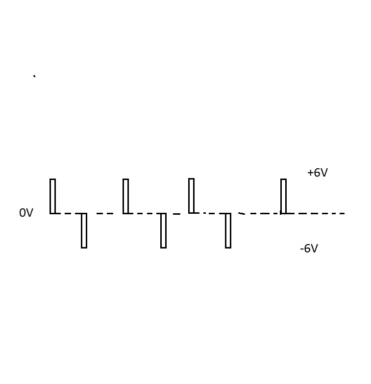

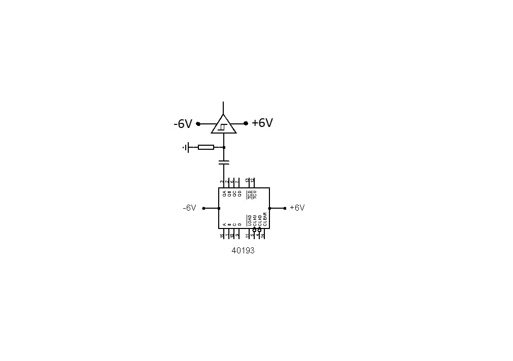

this is what I want to do.
at each change of state of the outputs in the binary counter 40193 a positive or negative pulse appears at the output of the schmitt trigger gate.
I took -6V + 6V as an example but I think I can also use -5V + 5V

In your circuit, the output of the Schmitt Trigger will never be at 0V, it will be +6V or -6V.

You're missing the meaning of 'binary', the output can only be in one of two states, high or low - and as AG has pointed out, this will be the negative and positive supply rails.
The circuit in post #5 will not work as shown, because the output of a standard logic gate is never stationary half-way between the rails.
If you want the output of the circuit to rest half-way between the rails, and pulse in both direction, you cannot do that with logic gates. Opamps and comparators can do what you want.

The Schmitt Trigger or a slower opamp will be destroyed by the +18V and -18V spikes produced by the capacitor.
Also the peaks of the pulses will be slanted, not square.
So you want 3 states. -6V, +6V and 0V.
Connect the output to a 10k resistor to 0V. Now use one of these parts below. (note the 0V is not "strong" being set by a resistor)
4502 or 4503 or 40244 has a output enable pin that will cause the part to go "tristate" or no pull up or pull down.

When the digital goes to +6V or -6V then the capacitor charges 6V. Then if the digital suddenly goes to the other polarity before the capacitor discharges, the capacitor charges 12V more. The total is 18V. Bootstrapping in an audio amplifier boosts voltage like that.
