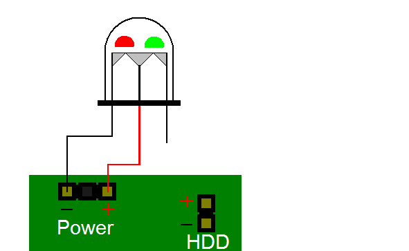

I have been searching for over a year now on how to get a dual color led to work with my motherboard. Ok, the motherboard has a constant negative and uses the positive pins to turn the power and HDD leds on/off. Now, the dual color led has a common positive and uses 2 negatives to operate both colors. I was thinking of a PNP transistor but at this point any suggestion would be really appreciated.
Thanks in advance.

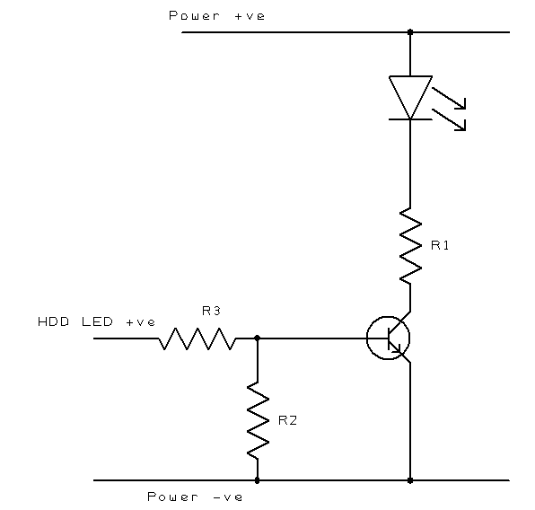

You would want an NPN transistor to drive each LED, as you are sinking current not sourcing it.
Or you could use an inverter such as a 74HC04.
Either way you need a 5 V source and current limiting resistors to feed the LED
Thanks for the reply, I made a diagram of my setup, (yeah, I used paint brush lol) and I think I want to try the NPN transistor, now i'm very visual so if you can modify my diagram I would really appreciate it. Thanks
This is the circuit you need for each LED.
R1 should be about 330 Ω and it is needed to limit the LED current
R2 and R3 should be 10 kΩ
The transistor can be just about anything NPN
https://en.wikipedia.org/wiki/Transistor says how it all works.

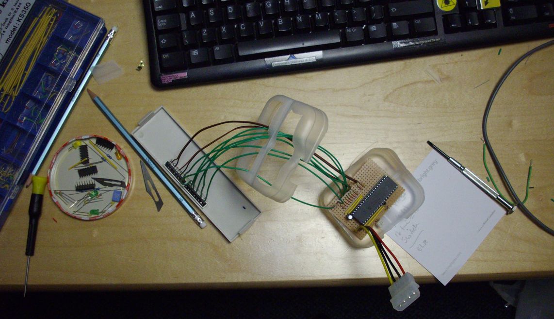

That looks really sweet DMW, definitely a cool case mod. But I only have room for one single LED in my project. But I would love to make one some day.
