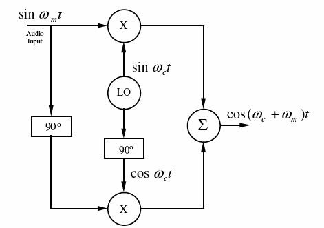

i need to design a AM-SSB using code composer studio
The AM coding is under the rulph chassing dsp book , problem is how to make it to SSB..
Can Anyone help me ...
please
( if u need the AM coding , i will upload it )
In functional notation, you can perform the functions shown in the attached image. The AM signal is input on the left, and the AM-SSB signal is output on the right.
thank...
This is phasing method...
My project need to use the filter method , apply the lowpass filter coding to the AM coding...
This is the AM coding.....I already try to put the lowpass filter coding into it but still have error ...so need some help in here

See: output[k]= carrier[k] + ((amp*baseband[k]*carrier[k]/10)>>12);
I don't understand why you have the carrier[k] term added in the beginning. To use the filter method you start with a double sideband suppressed carrier signal which is the modulating signal (baseband) multiplied by the carrier signal (carrier) with no DC offset, which is what it looks like you have there on the right side, alone. Then you apply the filter to extract one of the two sidebands.
ok.Thank...
then is output[k]=((amp*baseband[k]*carrier[k]/10)>>12);
and apply the filter code ???
Can u guide me to apply the filter code . Please and Thank
Because i apply this filter code and the coef file , but there still have a error
Yes, though I have to assume you are dividing by 10 for scaling, and I don't know enough about your code language to understand the >>12.
I don't know enough about your code language to verify your filter code. I can tell you that you need to make the filter to pass either 2400 Hz, or 1600 Hz (given your carrier of 2000 Hz and modulating signal of 400 Hz), depending on which sideband you choose to extract, and bandwidth of the filter should reject the other sideband.
