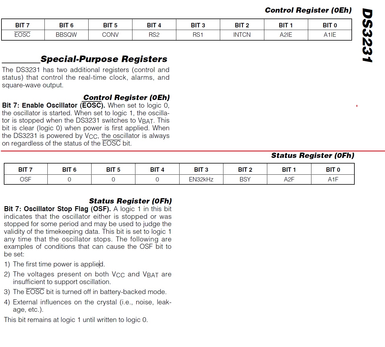

I'm doubt on "Enable Oscillator (EOSC\) Bit" in control register. The Datsheet also says the "Oscillator Stop Flag (OSF)" bit in status register.
1) What do I have to check on power up?
2) Is it ok to configure the control register on every power up?
3)Do I need to configure it everytime when I adjust my time?

If the OSF is set when you powerup then something stopped the clock and the time can't be relied upon. If the flag is set then warn the user that the time is incorrect and the battery may need replacing.
Good point.Just thinking no point of checking the OSF flag bits.Because the Control bit is automatically sets when battery is placed.So no point of reading it every time power up?
I'm not quite sure what you're saying. However, if the unit is powered down for a long time and the battery goes flat during this time then the OSF bit will be set and the time will be wrong. That is the purpose of this flag.
I'm making clock to my room.circuit is powered from a power pack.and there is small power cuts in day today not longer power cuts.In this case I am wondering do I need to check status flags and control bits in the initialisation part?
If the OSF bit is set then your time is probably wrong and you need to reset it. The battery will probably last a couple of years with intermittent power cuts so when it's set you probably need to replace it.

AFter reading the datasheet many many times I got to know that no need of writing to control register on Its very first power ON stage. Its initial values are ok for a normal run.
