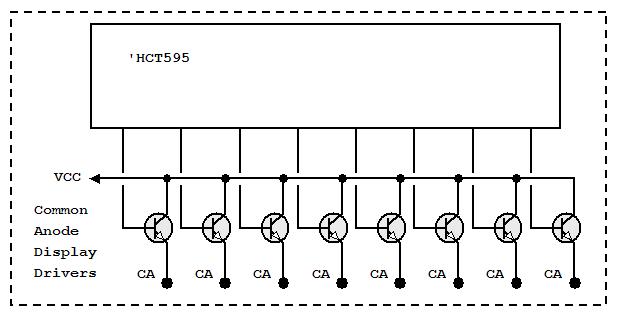

Arrow,
The ULN2803 is a 'sinking' driver... Don't you want a 'source' driver to drive the Common Anode columns?
The other part you were looking for is an Allegro UDN2981A 'source' driver, not a ULN2981A...
Here's an 'HC595/Transistor example (one of many many different ways to do it)... I forgot to include the current limiting resistors between the transistors and the CA connections...
Regards, Mike

Hi Mike
Thank you for your diagram. I shall try it.
Can you please recommend a part number (wiht sufficient current) for the transistor?

choose a PNP darlington, TIP105, TIP30, etc... or something smaller, like a BC series - how much current did you need to source again?

arrow said:
I need to source 140mA- will the parts you recommend work (I need a through hole component)? and What should Vcc be- will 5V be enough?
140ma - no sweat!
get a hold of some 2N3906 transistors ... they are through hole and should be super cheap ... each can handle 200mA continous. Something like the 2N4403 can handle 600mA, but when you start getting into the higher currents, you really need a darlington, because the base current demands start getting pretty bad - hopefully someone with a better understanding can clarify this some - I just have a loose handle on the idea. of course, if money is no object (haha), you could use p-channel mosfets, which can source unbelievable amounts of current with next to nothing in terms of gate current (they rely more on gate voltage)
if you're looking for a place to buy the 3906 (or others), Futurlec ships all over the world, for a pretty low price (they tend to be a bit slow at times, not the best choice if you're faced with a deadline)
5V for VCC is fine for the HC or HCT series of the 595... I haven't worked with other series, so I couldn't say for sure (I think the LS series requires TTL voltages, 12v?)
keep in mind the transistor will be inverting your signal from the 595, so when you set an output in your register to 0, the transistor will come on ... setting the output to 1 will turn off the transistor.
