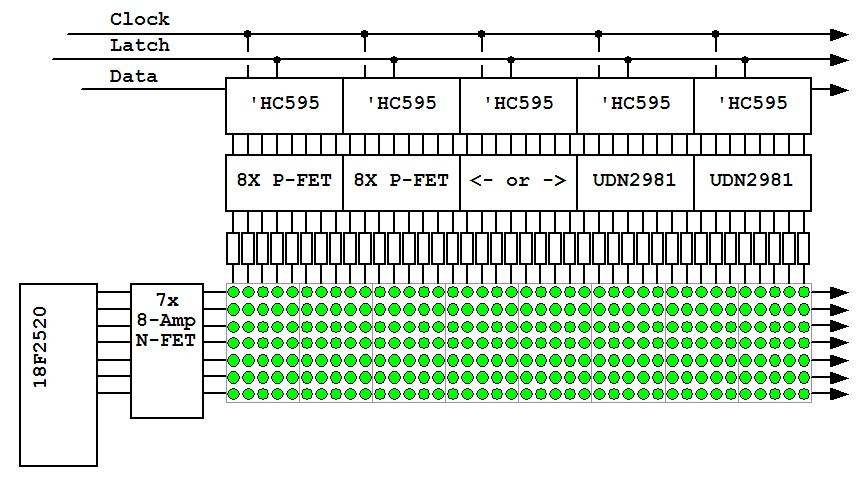

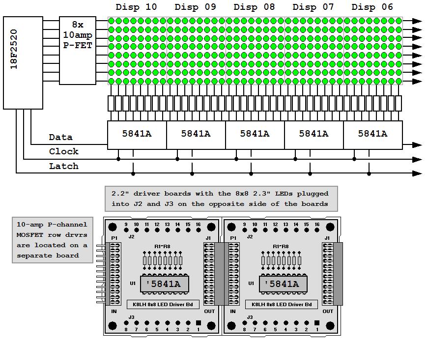

If you're using the 'HC595 to 'sink' current to a column (common cathode), you might consider switching to a Micrel MIC5841 IC instead... It's a serial to parallel 8-bit 500-ma sinking driver (example below)...
It might help if you tell us about your configuration... Is it several 7-segment displays or 5x7 or 8x8 matrices? Common cathode or command anode columns? Are you 'scanning' columns or rows? LED duty cycle?
Good luck with your project... Regards, Mike

I suspect you will want to 'scan' the seven columns for an overall 14.3% LED duty cycle... Overdrive the LEDs for adaquate brightness... I suggest using seven N-Channel MOSFET row drivers (or NPN Darlington, or....) capable of sinking the 100 LEDs in each row and P-Channel MOSFET (or PNP transistor, or UDN2981A) 'source' drivers for the columns...
I suspect you realize you'll need a 3 or 4 amp power supply to drive the 100 LED rows in your twenty 5x7 displays...
