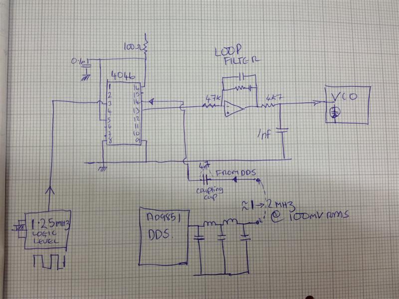

HI All,
I am building a PLL circuit using a 4046 and and also a DDS chip, as part of a hybrid PLL/DDS synthesiser.
It all worked fine, then I spotted that I had accidentally used a 74HC4046 device, and the supply rail was 8 volts! No problem , I swapped it for a proper CMOS 4046. I t stopped working, so I tried another, and another ( of different types, Motorola, Phillips etc) Still no joy.
Then I put back in the 74HC4046, and it worked again, so I recconected the supply rail to to a 5 volt one. It stopped working!
The reference to pin 3 of the 4046 is from a 10 MHz crystal locked CMOS oscillator (running at 5 volts), and divided down from 10 MHz to 1.25 kHZ via a divider.
The DDS output is fed to the signal input of the 4046 PLL, is around 100mV RMS.
Some sources I found say that the 4046 will lock up with inputs down to 20mV, others, like the Phillips Datasheet say 200mV RMS.
The 4046 has a self biasing linear amp on the input (pin 14) for small signals, or logic level can be used, in which case the capacitative coupling should be omitted (according to datasheet research on the internet).
Further research uncovered that Don Lancaster in his 'CMOS Cookbook', (and Forrest Mimms in his Circuit scrapbook' re-quotes him) saying that "The linear amplifier operation of pin 14 is an unmitigated disaster when the wideband (type II) phase detector is being driven" and suggests not using it.
So then I need to create logic level signals from my 100mV sine wave from the DDS.
What I need then is either a class A transistor amp or a class c or D biased version to give logic levels.

Without an actual schematic it's hard to tell.
If you have a scope, watch the input on pin 3. Use a couple high impedance resistors or a diode to bring the signal on pin 3 to an acceptable voltage window for the comparator of the 4046.
Maybe post a schematic-A picture is worth a thousand words
You can generate a digital signal from a 100mV sinewave with a comparator such as the LM339 or LM393. Be sure and add some hysteresis so it doesn't oscillate.
Note that most comparators, such as the LM339, have an open collector output and require a load resistor to the plus supply to generate the output signal.
Here's the schematic

I can't figure the schematic out. The block marked VCO is outside the loop. The steering voltage off the loop filter is capacitive coupled to the 4046 internal VCO control.
10 MHz is pushing the spec limits of the HC/HCT4046 phase comparator propagation delays, and the CD4046 is out of the question. It may work at 10 MHz, but it's not a reliable design. For the HC/HCT parts, at room temp, the signal input should not exceed 7 MHz and over the -55C to +125C temp range, the signal input should not exceed 5 MHz -- and that's assuming a square wave input. The comparator propagation delays are lower with higher supply voltage, which can explain the failure to work at 5V.

Beerbelly, - yes sorry, its not really a great schematic, I did it in a bit of a hurry, only drawing what I thought were the relevant parts.
The VCO output feeds a sample to the DDS and this then divides it down to 1.25 MHz, so it is in reality a closed loop
Sorry if my schematic isnt clear - I have a 10 MHz XCO that is divided down to 1.25 MHz, this is used as the reference for the 4046 PLL
EI3HG, it seems to me you should easily be able to get one volt p-p sinusoid out of the DDS (and the output filter), so that is another avenue to look at. Would need to see more details of how the Rset pin on the DDS chip is handled and the detailed Output filter and both DAC output pin connections. The DAC is a current output DAC, so if there is no/incorrect load impedance on the DAC output (and I don't see one in your schematic) to give a path for the current to flow, there will be low/no voltage output.
Realize your schematic does not show a complete PLL as the VCO output is not being fed back for comparison. I am only concentrating on the issue with the input signal at hand.

It worked perfectly though, after some slight adjustment to resistor values to alter the mark/space or duty cycle of the square wave. It still didn't reliably operate the 4046 though, as I am running the AD9851 DDS at 3.3v. This is because the controller I am using (an Atmel xMega256) runs at 3.3v.

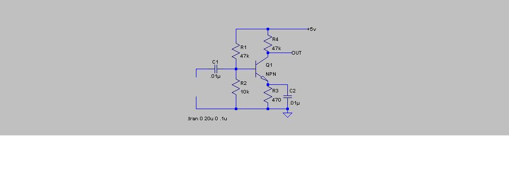

I tried a simple grounded emitter transistor to step up the voltage from 3.3v to 5v, and although the square wave wasn't all that square anymore, the 4046 locked up perfectly.
I could use level converters between the Atmel and run the DDS at 5v, and benefit from slightly improved frequency response, or fiddle with the single transistor level converter. Although the latter sounds simpler, from looking araound the internet, it appears that I could lose phase stability and/or add phase noise using this approach if not done carefully. Your thoughts appreciated though.

without the on-board clock and output amplifier, and on-board 5v reg. Really, I am using it just a carrier board for the AD9851 and the output filter components. I am running the filter at 51 ohms in/out impedance.
The RSET pin is just grounded. I am getting about 200mV p-p sine from the filter output, which seems to tally with the datasheet and the DDS-60 notes.
