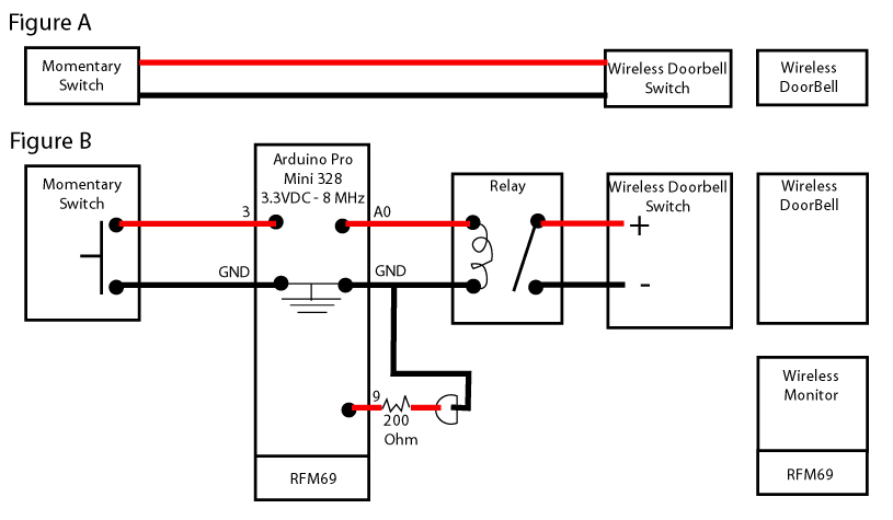

DoorBell goes off Unpredictibly
The internal pull-up resistor on an Arduino input is something like 20,000 Ohms.
That makes the inputs extremely sensitive to input noise (including static and nearby radio transmitters, mobile phones etc.)if there are anything other than fairly short wires connected. That's why I suggested an extra resistor to reduce its sensitivity to interference.
Also, rather than relying on there being an interrupt, check the input pin and verify it stays low for eg. 20mS minimum before considering it a valid switch activation.
I suggest you add code to the interrupt handler to verify that pin 3 (Which I assume is (INT0)/ PD2 on the ATMEGA328P) is still low at between 100 and 500 mS after the interrupt has occurred. If it not still low then take no action. You have still not given any details of the transmitter and monitor and how it is connected to your block diagram.
Les.
My Code change appears to have corrected the unpredictable doorbell ringing. However, another question comes up. That is, what may have caused the processor to wake up when the bell switch was not pressed?
I have modified Figure B and the raw code follows. Suggested changes have not be done yet.
Please suggest.
Thanks. Very interesting.
So far, I have determined that the unpredictable doorbell ringing was due to the processor waking up when no interrupt has occurred. My code change seems to have fixed that. However, something was causing the processor to wake up anyway once in a while.
Still, the switch line from the Arduino to the switch is 25 to 30 feet of #18 wire.
Maybe add a 1K resistor from pin 3 to ground?
That would short out the bellpush.
Put it from pin 3 to the +3.3V so the input is held high when the bellpush is not pressed.
If it still triggers erratically, you could add a small capacitor from pin 3 to ground/0V, to bypass RF interference. Try 10nF or 100nF, a ceramic or plastic film type.
Yes. Pin 3 to +3.3V. I don't know what I was thinking.
