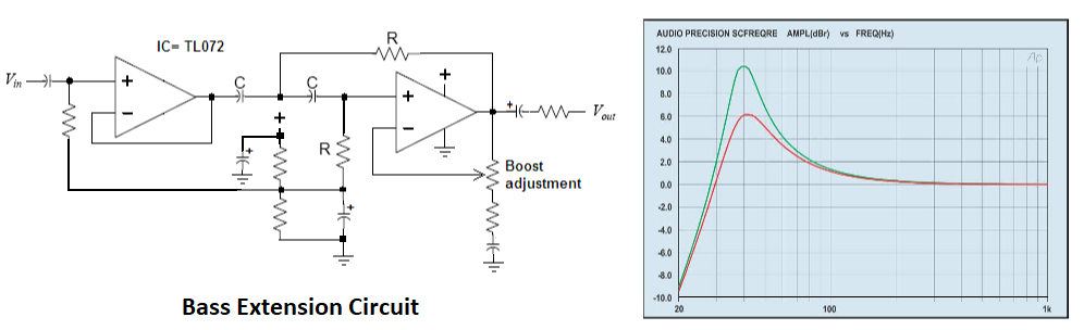

My main stereo speakers are flat down to 50Hz and I added a bass boost circuit so they can play flat down to 30Hz. Since the mids and highs are reduced but the deep bass plays at maximum power then you lose some mids and highs power.
Here is a bass boost circuit for you:

As for bass extension, i am not really sure how that would end up being on TCP115. They are 55-5000Hz and somehow i doubt they can give anything more than they are already giving. But if you think it will work, then i will look into it.

2) You were talking about bass boost. I am interested in this idea (if i understand it right, this way i could adjust the case resonant frequency so its F3 would be higher but that would mean big boost in frequencies under 100Hz and help with loudness). But how does that translate to the speakers ? I am pretty sure at 40W i am driving the TCP115 4 ohm as much as i can. Do you think it has anything else to give with bass boost or will it just mean insane distortion ?
A bass boost circuit allows the very low frequencies to be at full power but the mids and highs have reduced power.

Hmm but i am not sure i want to trade very low frequencies for mids and highs. I mean does that mean i will have less power at 70Hz and more at 40Hz ? Cause that i cannot trade. But if we are talking about 150Hz and up, then we can talk about it.

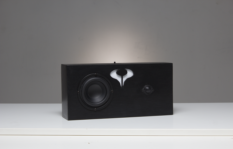

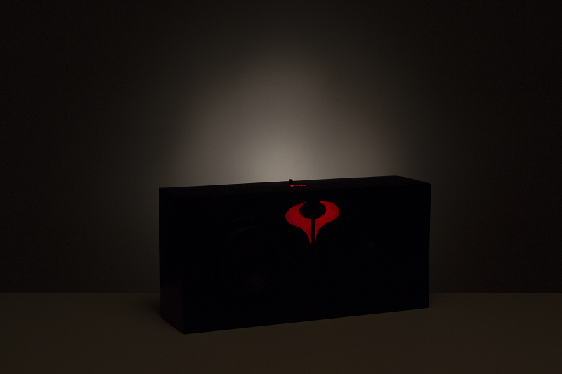

My newest speaker, the one i made for me, went to a photoshoot today. Didnt have time to go through all the pics yet, but just 2 to give you an idea what it looks like. Oh and if ur wondering what that sign is, its a sign of goauld system lord Kronos (stargate sg1 series :D)

So, what do you think about the pictures ?

1) What do you think about the pictures
2) How will my speakers handle this bass boost. Let's say for starters we do a very mild boost (i dont even know how this goes but, 3dB seems small value enough). Will they start badly distorting ?

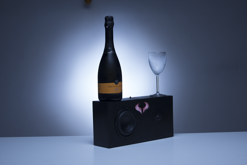

The 750ml bottle shows that your speaker is fairly small. I am glad that its performance is good.
A speaker produces distortion when its input power exceeds its truthful power rating, I guess its coil is hitting the magnet structure. A ported speaker enclosure causes the woofer to move more at frequencies below the port/enclosure tuned frequency requiring a sharp cutoff of those lower frequencies.
I think an amplifier and speaker should have extra power headroom so that its output power is more than you will ever need so that it never produces clipping distortion.

The speaker in the image is 4L and has F3 of 55Hz (that is ofcourse if speakers data can be trusted and if winISD and Qspeaker gave me the correct data). I am very happy with the speaker and so are my friends. I just got the nice dayton tweeters so i plan to replace this cheap aliexpress tweeter with it.
Sadly this speaker still has the same stereo problem. It only happened to me in 2 songs so far that actualy use stereo. But it is a bit disturbing at the beginning of song when only the tweeter is playing and since its mostly low frequencies you basicaly hear nothing. I am still waiting for those mono amplifiers and receivers, so i can actualy mix the thing into mono. But this nice little black amplifiers with volume knob are so nice, i am actualy thinking if it would be worth to figure out where on the board the signal is going into the actual amplifier, unsolder the things there and mix it into mono and then just feed mono into each channel. Would be hard though cause this thing is very small.
