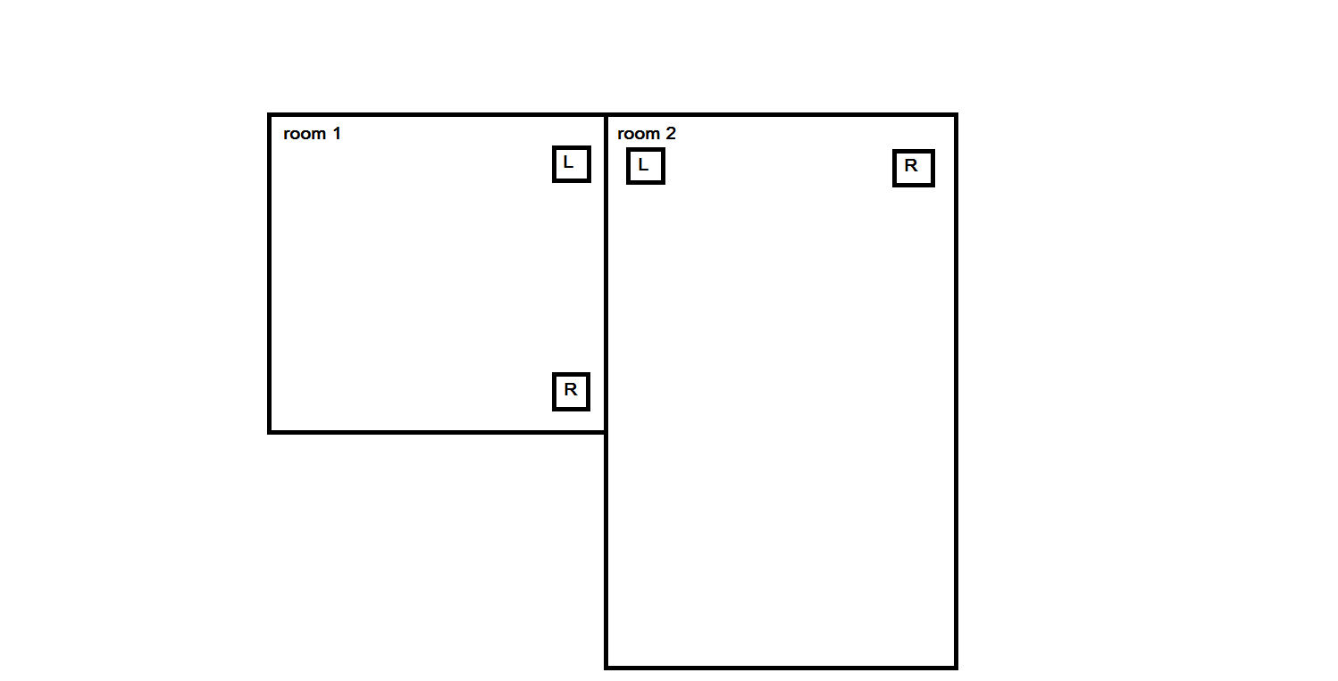

Ok, so my dad is excited about my idea for his speakers. He wants the speakers to be able to play in 2 rooms at once. That means left and right speaker in each room. I draw up a simple scheme to give you an idea. I want to use a bluetooth amplifier for this, since like i said, he doesnt have amp, wants it to be as compact as possible and having an option to use bluetooth on mobile phone to play music is an added bonus.
He wants a separate control of music in each of the rooms. So for instance, if he wants to only listen to music in room 2, he will simply turn on the volume in room 2 and turn it off in room 1. It would even be an added bonus if he could control speakers in room 2 from both room 1 and room 2.
So there are a couple of questions i need to solve. Do i use only 1 stereo amplifier ? Do i connect 2 sets of speakers to each channel in parallel (and make sure amplifier is strong enough for that ?). Or do i buy an amplifier with option to connect 4 speakers ? Do i separate audio receiver (3.5mm jack and bluetooth and then separate amplifier) or use combined ? Do i even use a small bluetooth board or maybe buy some small already made amplifier of compact size ?

A separate volume control for each room indicates a separate amplifier for each room since the volume control is at the input of its amplifier.
But if each room does not need separate volume then the speakers can be switched on and off with a switch and a single amplifier must have spec's that it can drive both sets of speakers in parallel.
Yeah, i kindof came to the same conclusion as you. So basicaly i have this two options:
1) separate amplifier in each room, each with his own volume knob. And then i would send audio from 1 receiver to two amplifiers (if thats possible ?)
2) 1 amplifier and 1 receiver, volume control in room 1 and in room two only a button to turn the speakers on and off

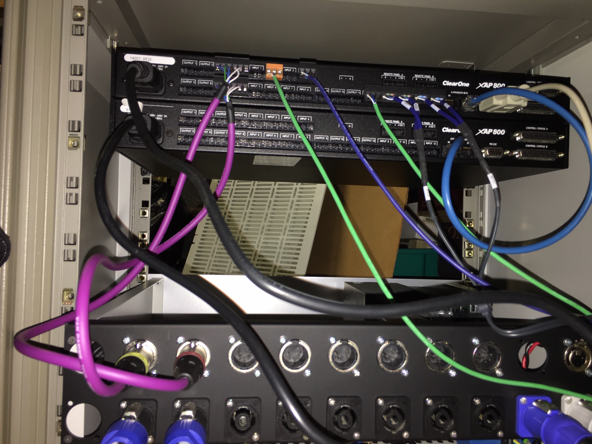

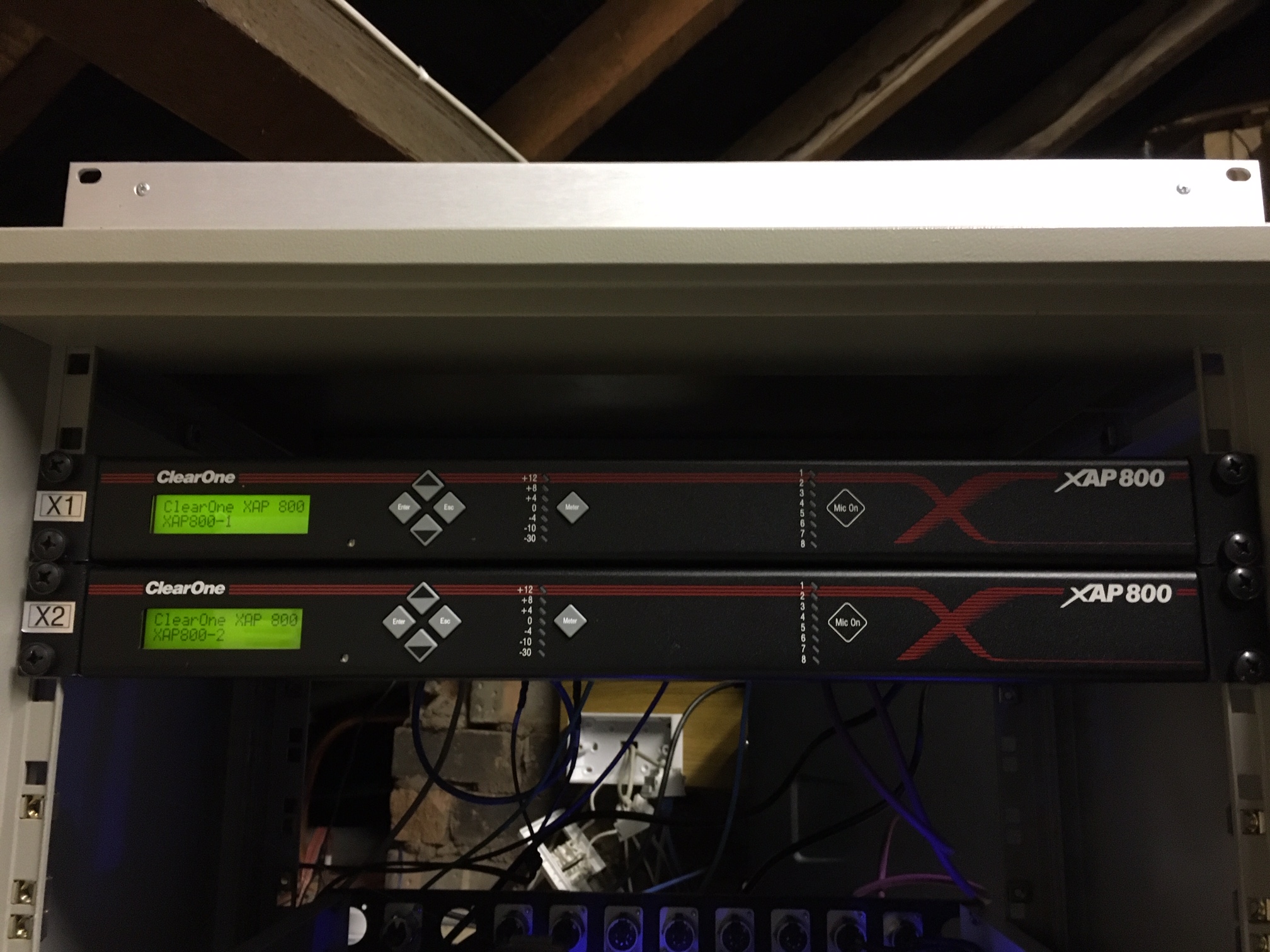

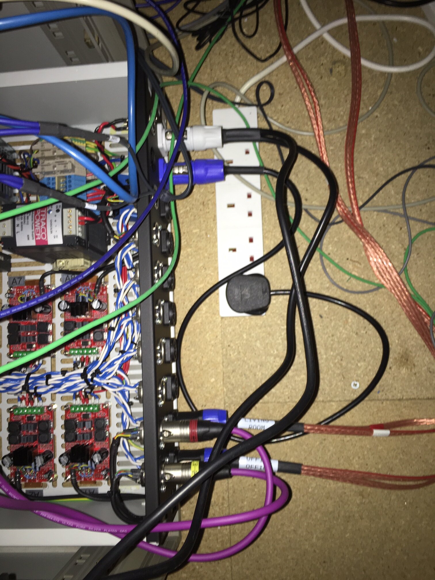

I'm part way through redoing my whole-house system to stereo everywhere, from the mono system I built 20 years ago when I first moved here.
Only a couple of pairs of speakers and amp inputs from the mixers are connected in at the moment as I'm still rewiring rooms, as I get time.
The amps are ebay TPA3116D2 stereo modules, modified for balanced input as I posted a few months back on here & with extra heatsinking; they work very well, using an old industrial 24V 10A supply.
The XAP800 mixers higher up in the rack are superb for multi-room setups, they have 12 inputs & 12 outputs each that can be cross-connected or controlled either by a computer serial link, or by creating preset scenes that can be selected directly by switches.
And they are often only around 20- or so on ebay, to give facilities that cost thousands in branded audio gear.
With mine, they also handle mics for voice control and echo cancellation on those so they ignore music etc.

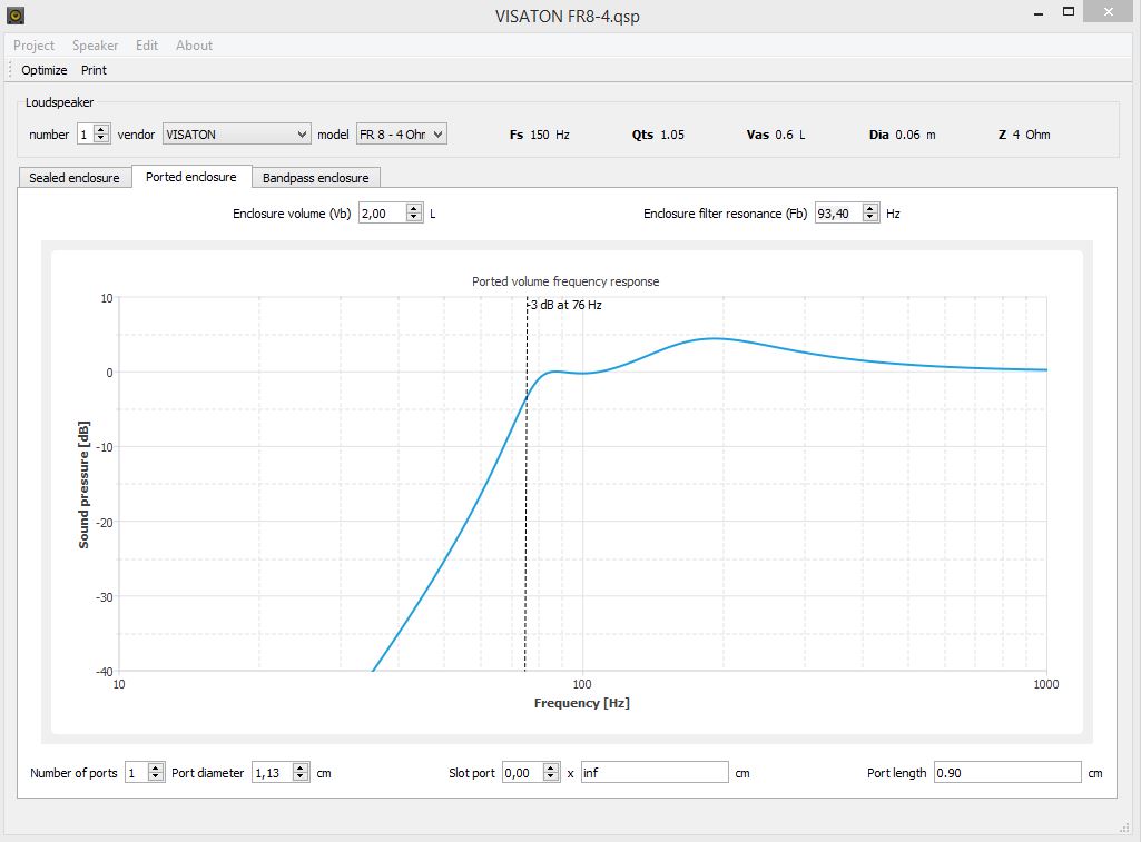

Ok i was playing around a bit with different speakers, just for fun. So i remembered i have 4 visaton FR 8 4 ohm laying around, i never got to use them. So i imported them into my QSpeakers app that i like. And well, i have to say i was surprised. This speaker, if u read its data, has no bass whatsoever. But watch what happens if u put it into a ported box. Ofcourse this is not enough bass for someone who wants to listen to techno. But what about Bach ? Mozart ? Granted we would like a flat line, not this wavey nonsense. But in this price range without making speakers stupidly crazy ?

In the ported little speakers, I think the increased output at a few hundred Hz will sound "boomy" and the missing bottom 2 octaves will sound bassless."
Dual cone speakers produce inter-modulation distortion of the high frequencies. The power rating is a joke (hundreds of Whats!) and the frequency response spec means nothing without saying its deviation from being flat.
I will test it out just for the sake of fun, i really really wanna see how it sounds. When i create a 3L enclosure for my new speaker, i will test it in that one. Boomy because of mid might be problematic. But do u think missing bottom 2 octaves would be a problem when playing classical music ? I guess i will have to see and hear. As for the other speakers, even if they are fine, there is no data to calculate the enclosure, and i dont feel like testing my luck again as i did with my first speaker, doubt i will ever get that lucky again.
