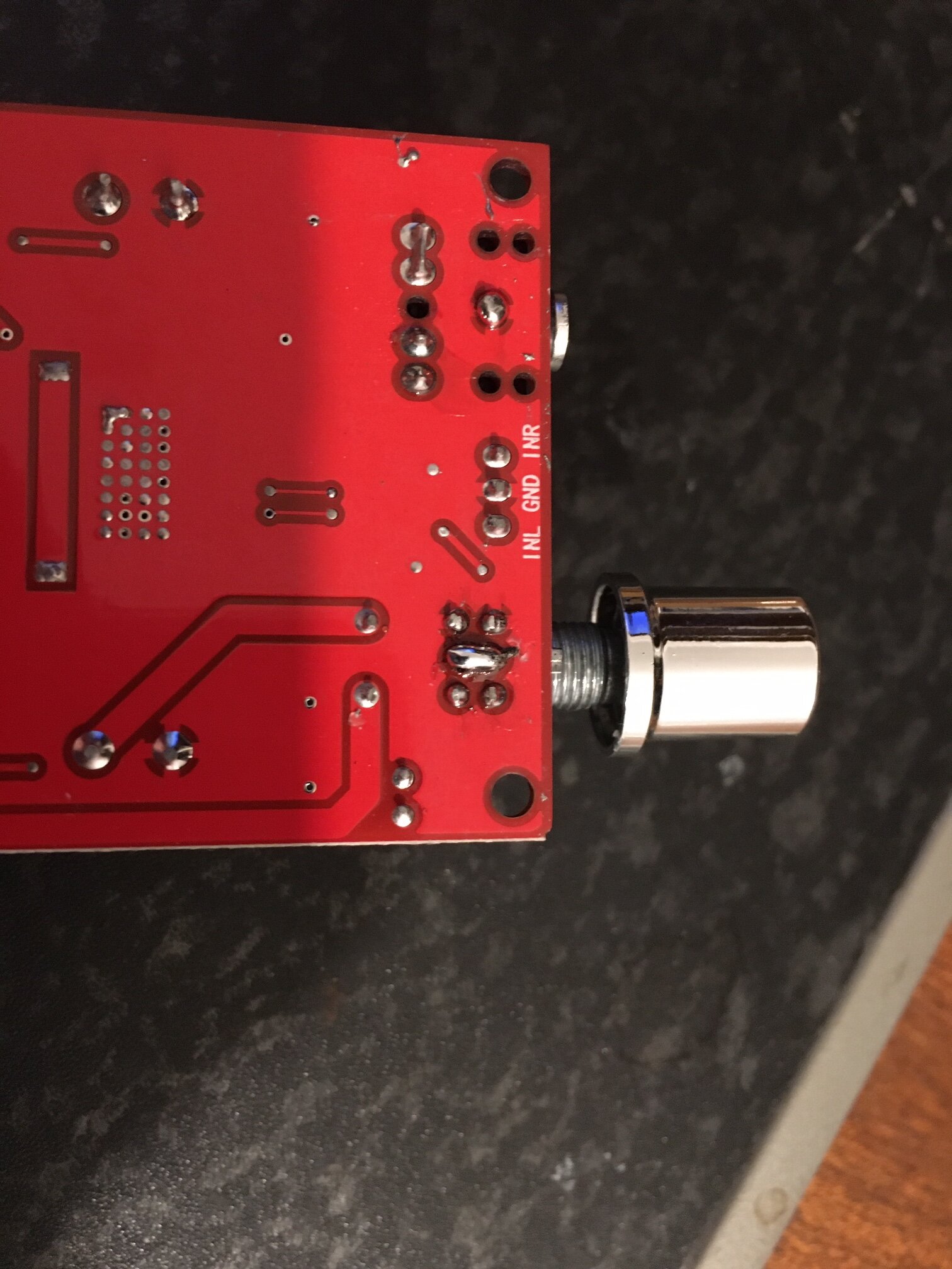

Someone on forum seemed to have found a simple solution so i could have mono and still keep my WUZHI which i love so much. He said there are 2 options:
1) Simply solder the 2 signal pins together on the pot and test if you get much distortion at higher levels (image in the attachment)

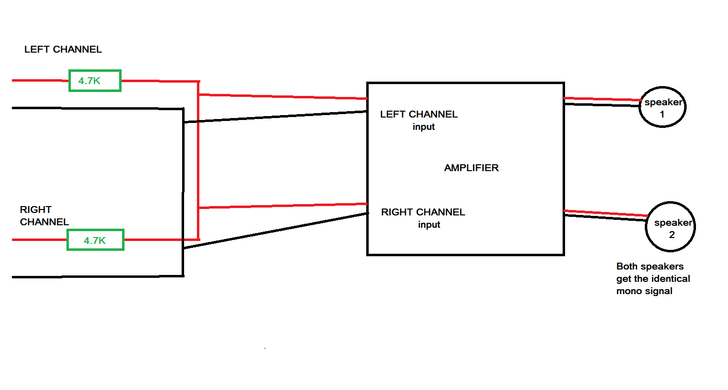

2) remove the knob and just do a stereo mixing as i would with separate receiver and amplifier board. I dont really need the knob anyway, never used it. I made a scheme of stereo to mono and would like you to comment if i did it right ? ()
You do not need to add resistors since the volume controls already have the resistors in them. Connect the volume control sliders together to make mono and turn down the volume controls maybe 10% from maximum so that the Bluetooth channel outputs are not shorted to each other.
The problem is sooner or later someone will turn the knob all the way and short it. Can you verify that the second scheme image is correct ?
It might be impossible to cut traces on the Bluetooth receiver and add the resistors so I guess you must add a little circuit board with the added resistors, then the little circuit board is connected between the Bluetooth receiver outputs and the amplifier inputs.
