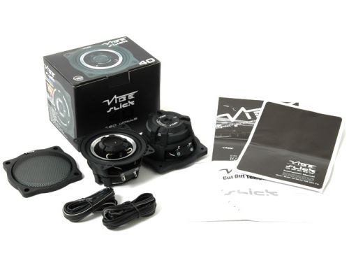

Have a look at these:-
The three little mid-woofers will not produce good bass in a small portable enclosure.
The 4.5" Dayton needs a large sealed enclosure but it has high sensitivity.
The 4" Peerless has a resonant frequency too high and poor sensitivity.
Both above need a crossover network and a tweeter.
The Vibe has no detailed spec's.
