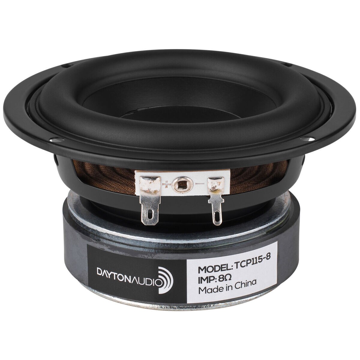

The 4" woofer from Parts Express is much better than my old ones and if you make the enclosure large enough (3 litres) and a port tuned to 50Hz then it will make good bass sounds.
I will make the enclosure as small as possible, like always, for portability. I guess 3 litres is doable, its still compact. I plan to use passive radiators, the same ones i used in my last speaker. This time maybe i could seal the rear end of full range speaker ?
1) An enclosure that is too small increases the resonant frequency of the system with a peak and cuts lower frequencies= no bass.
2) Passive radiators that have spec's that do not match the spec's of the woofer are like holes in the enclosure allowing low frequencies at the rear of the woofer cone to go through the holes to cancel low frequencies at the front of the woofer cone= no bass.
3) The woofer has a good midrange response so you need a tweeter that is already sealed. Then add a simple crossover network which is an inductor in series with the woofer to cut highs, and a capacitor in series with the tweeter to cut lows. The tweeter will also probably need an attenuation resistor in series to reduce its sensitivity to match the sensitivity of the woofer.
If you seal the rear of a midrange speaker then you will increase its resonant frequency so high that it will sound like a low frequency fog horn.

Btw when i get the 4" woofer i will ask u to help me design the enclosure. That is, the size. As u know i am trying to keep it as small as possible. So maybe u can help me find the optimal size that will be best compromise between bass and portability. Oh, and i also decided i will use 1 woofer to make speaker in the power suply enclosure. Just because i am interested how that would work. And yes obviously i know bass will be a lot less then it would be in bigger enclosure but i still want to test it.
The woofer in a ported or passive radiator'ed enclosure flops around with no control below the enclosure/port tuned frequency.
Maybe your enclosure/port tuned frequency was too high then the woofer had no control at most bass frequencies.
If the tuned frequency is 40Hz then when bass plays frequencies near 40Hz the cone of the woofer hardly moves since the port or passive radiator makes those frequencies. But at frequencies below 40Hz like 20Hz then the cone moves Uncontrolled which might break its wires. Bass is seldom as low as 20Hz.
Your enclosure/passive radiator was probably tuned to 100Hz or 120Hz which cause the woofer cone to move a lot all the time with lower frequencies, but your videos showed the passive radiator also moving a lot. Maybe your woofer could not survive the high power, low frequencies you fed it.
