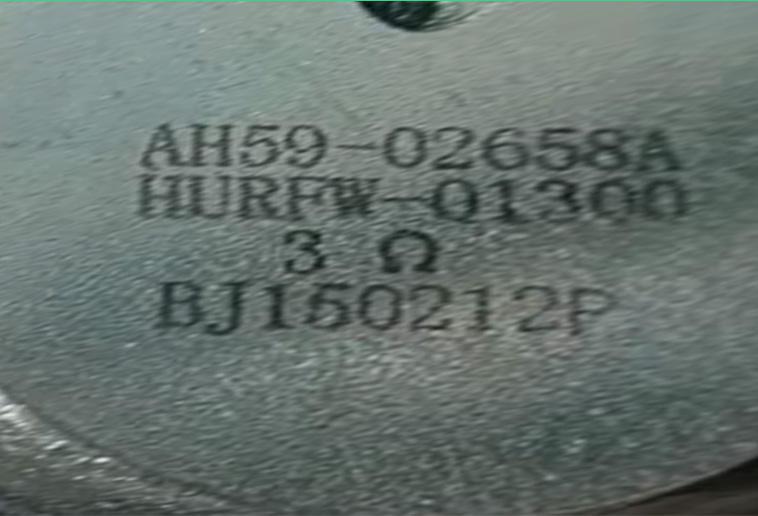

Just out of curiosity I captured the text off the back of the speaker in the youtube link; it does appear to be the same as your Aliexpress one:

I've got some of the boards as in the video, they do appear to have genuine Texas ICs - they are some of the batch I pulled the heatsinks off because they were on rubber...
Yes, i noticed that too. Its funny that typing those numbers into google showed me that youtube link with samsung speakers, even though nowhere in the video name are those numbers. Impressive. But it doesnt help me as i still cant find any data on the speakers, like sensitivity, frequency response, etc. I do like the name samsung though, makes me feel like its not a complete cheap thing.
1) We talked about the TDA7492Pm amp IC before. It cannot use a heatrsink on its top so it has a low output power so that it does not overheat and shut down (your problem?) and cannot drive 4 ohm speakers.
2) The AliExpress speaker is the same as the Tympany speaker from Parts-Express? Its datasheet shows that when it is in a HUGE enclosure it produces less output below 150Hz so no bass. Your small enclosure will cause boomy sound at 180Hz to 200Hz then less at lower frequencies (no bass).
Samsung probably buys the speaker from the same place as the other places buy from.
