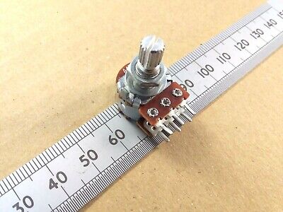

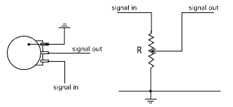

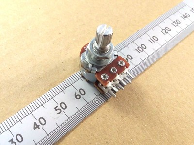

Just add a dual-gang logarithmic pot between the bluetooth board and amp.
Use one half for each channel, with the anticlockwise end connected to the audio ground, clockwise end connected to bluetooth board out and wiper contact (middle, usually) connected to the amp in.
That's a standard "volume control" configuration. Either 47K or 10K should be a reasonable value.
eg.
Viewed from the back, though a dual gang will have two sets of contacts & you use one set for each channel:
