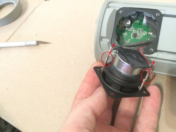

I've got a JBL "Charge 2+". That has amazing low frequency response for the size; bass guitars and bass drums are very clear but still with a good smooth overall frequency response, it's not "boomy" like a far more expensive Bose model one of my friends has.
The end panels on this are more like waterproofing membranes over the ends, which can incidentally be seen to vibrate, than true passive radiators (as my big Goodmans cabs have).
The casing is far too small to be tuned in any way.
The "secret" appears to be some very well designed and somewhat unusual long-travel speakers plus good amps and well matched equalisation.
These are the speakers in the model I have:

(Photo from an ifixit teardown, here: https://www.ifixit.com/Guide/JBL+Charge+2+Plus+full+disassembly/97318 )
I guess i will try to play around with radiators and see if i can produce any bass at all while speaker being compact, being compact is most important cause i dont have much space in my backpack. Loudness is second i guess, quality/bass is less important since we usualy have some beers when we listen to it and its not that important, though if i could improve bass even a little, i wouldnt say no to that.
