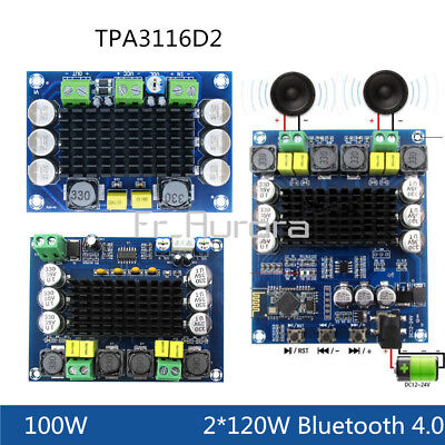

The datasheet of the TPA3116D2 recommends a 26V max supply and shows it with a 21V supply producing 50W per channel into 4 ohms at a horrible 10% clipping distortion. With a 21V supply it produces about 37W per channel into 4 ohms with low distortion or about 22W per channel into 8 ohms at low distortion.
The ebay Chinese TPA3116 Bluetooth 2.1 Amplifier has tiny little heatsinks so I bet it overheats. It does not say it can survive driving 4 ohm speakers so maybe its output is peak (double the real power) very distorted 50W per channel into 8 ohms?
I found this amp, it would be great but it has buttons instead of screws for volume. And since this will be inside the speaker i will have no access to buttons. And once batteries run out, the buttons will be at their default volume so this is useless for what i need
I ordered this amp and will see how it works. It only has 1 volume thing but its better then nothing. My plan is to find out the point where i can have volume on mobile phone at 100% and use this dial to lower volume on the board itself, to have no distortion. Then glue the dial in place.
The high power amplifiers have small heatsinks that rely on ambient airflow for cooling. The amplifier will probably overheat inside your little speaker.
It looks like the new Bluetooth Amplifier has a stereo volume control but they do not say so.
I will add a fan that starts spinning when temp of heatsink is above 60C. Well the picture shows the volume control, so if it comes without it, i will refund it.
