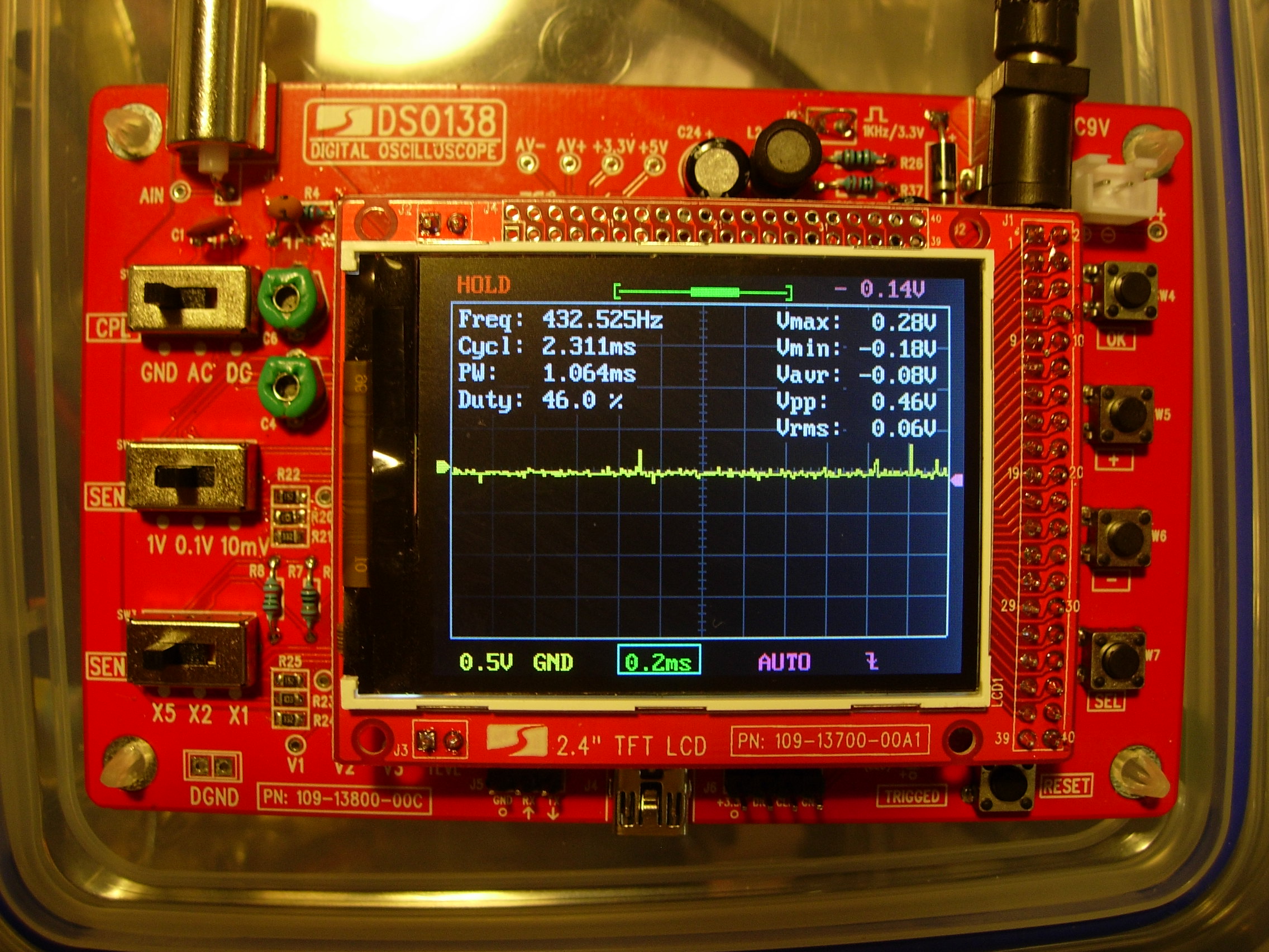

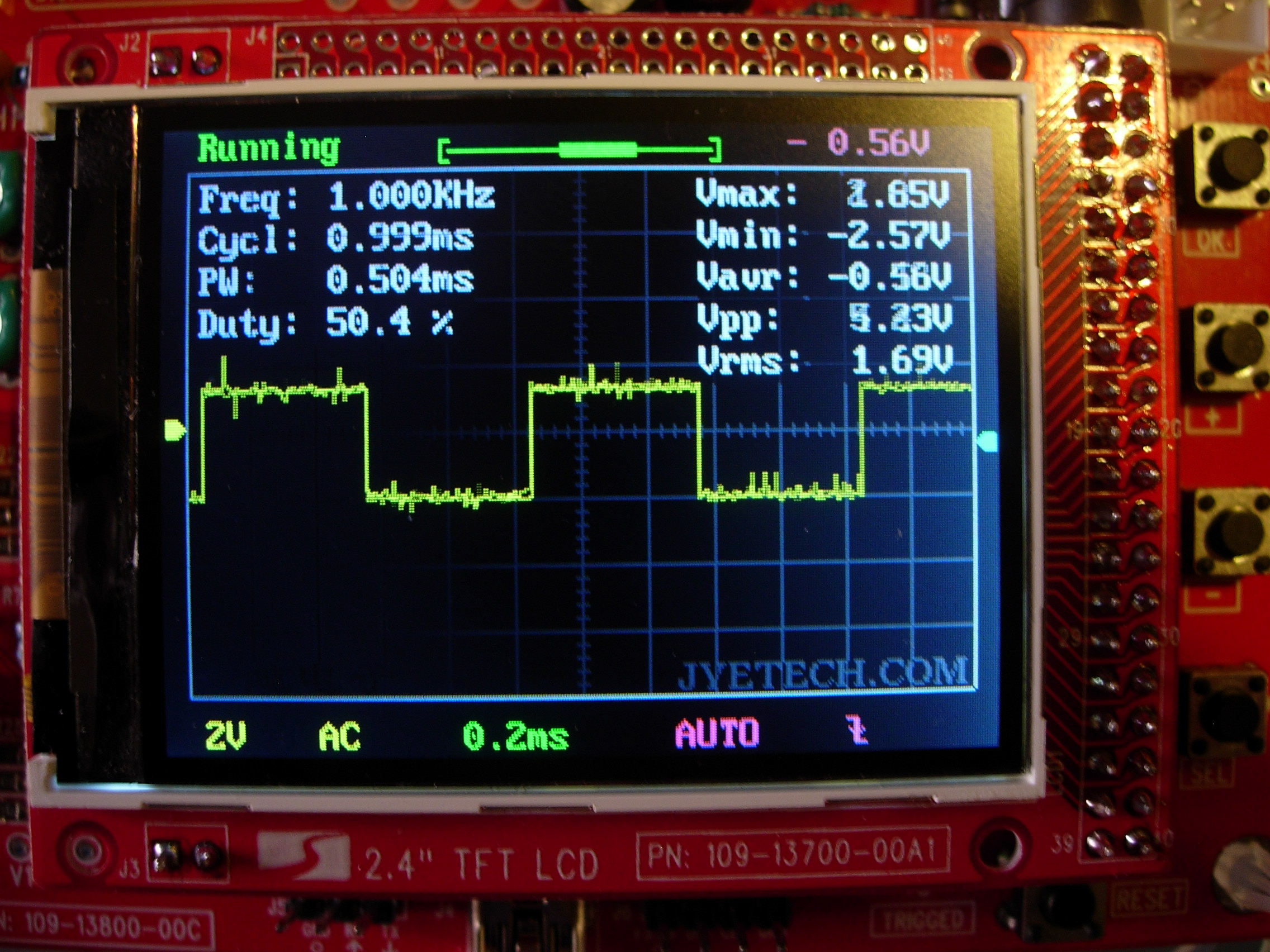

Finaly worked it out. Has any one else found theres a lot of noise on the waveforms? Is it the op amp creating the noise?
This is the switch CPL in GND position, so the noise definitely is internal. Might have to investigate it.
I was planning sticking my Rigol scope on the output of the opamp to see what noise was coming out of there.

My base line stays in the center of the screen & stays there when re powered. Guess il just have to get the Kenwood CRO out & see where this noise is comeing from when I get some spare time.
You have a later version of the firmware. I don't get the data you show on screen such as frequency.
I suspect there are some bug fixes too. One is documented.

On screen Data is obtained by holding down the OK button longer than 2 seconds to display it or remove it. They should be about the same units as I purchased mine about the same time as yours flat5.

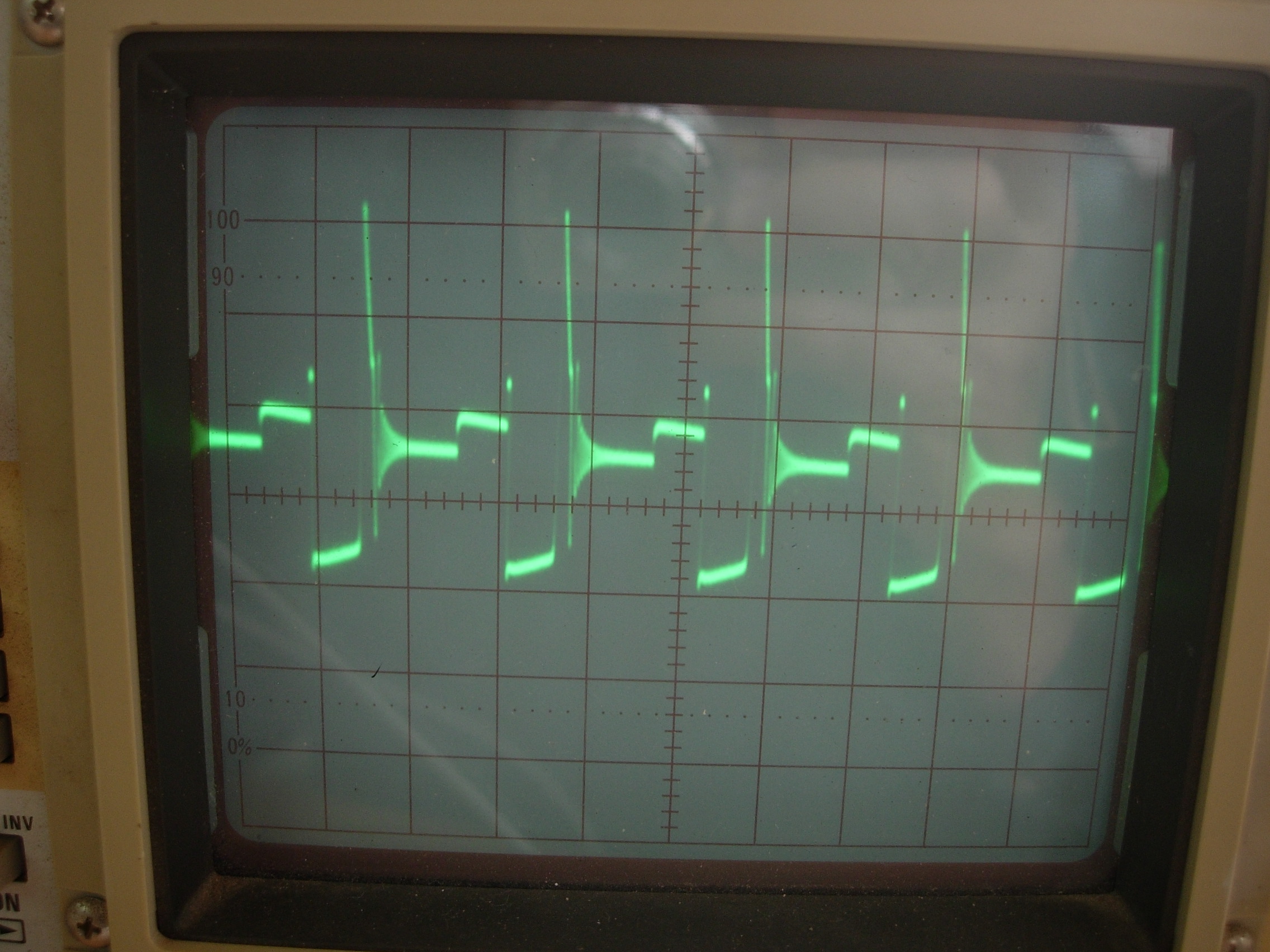

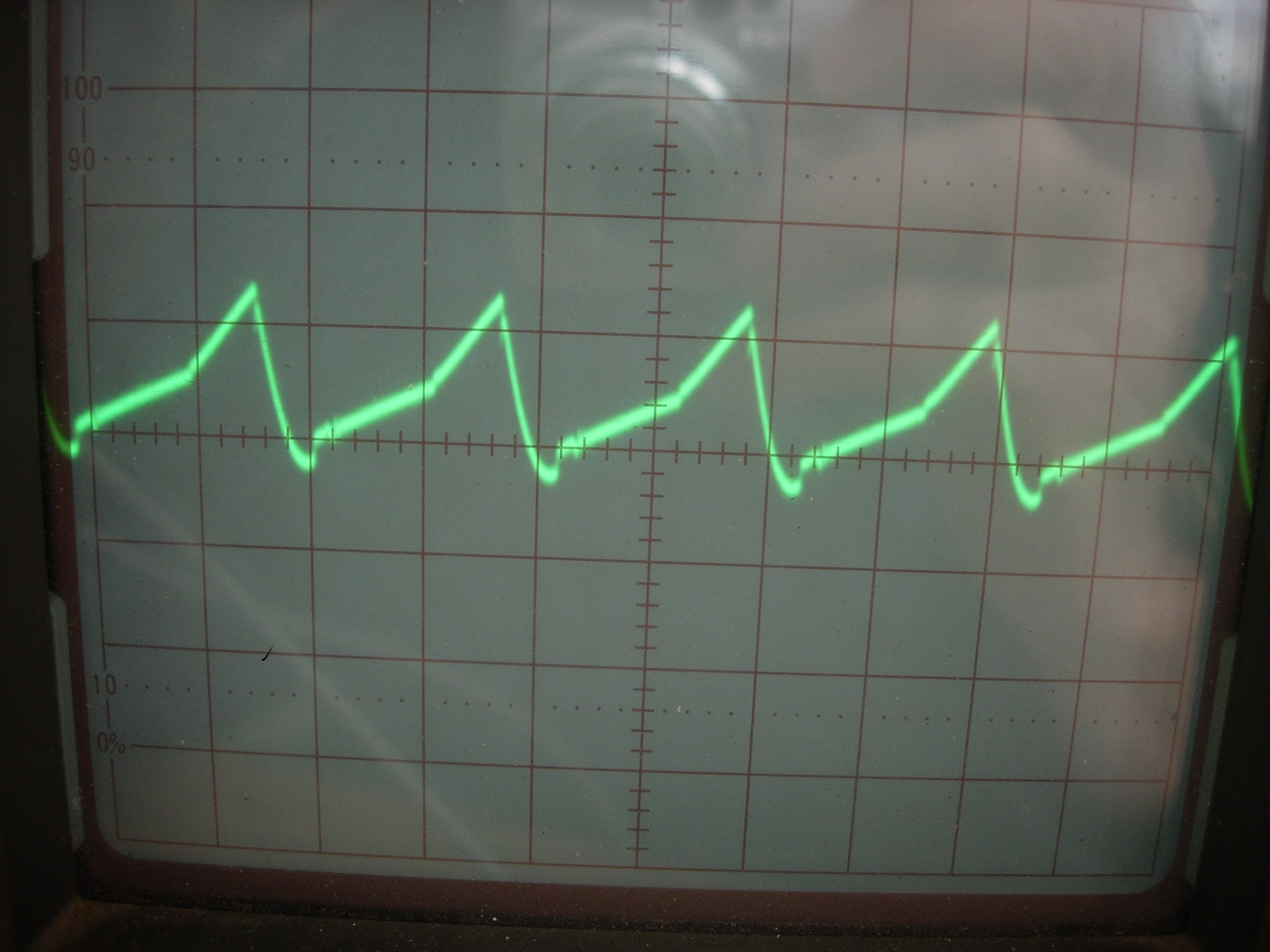

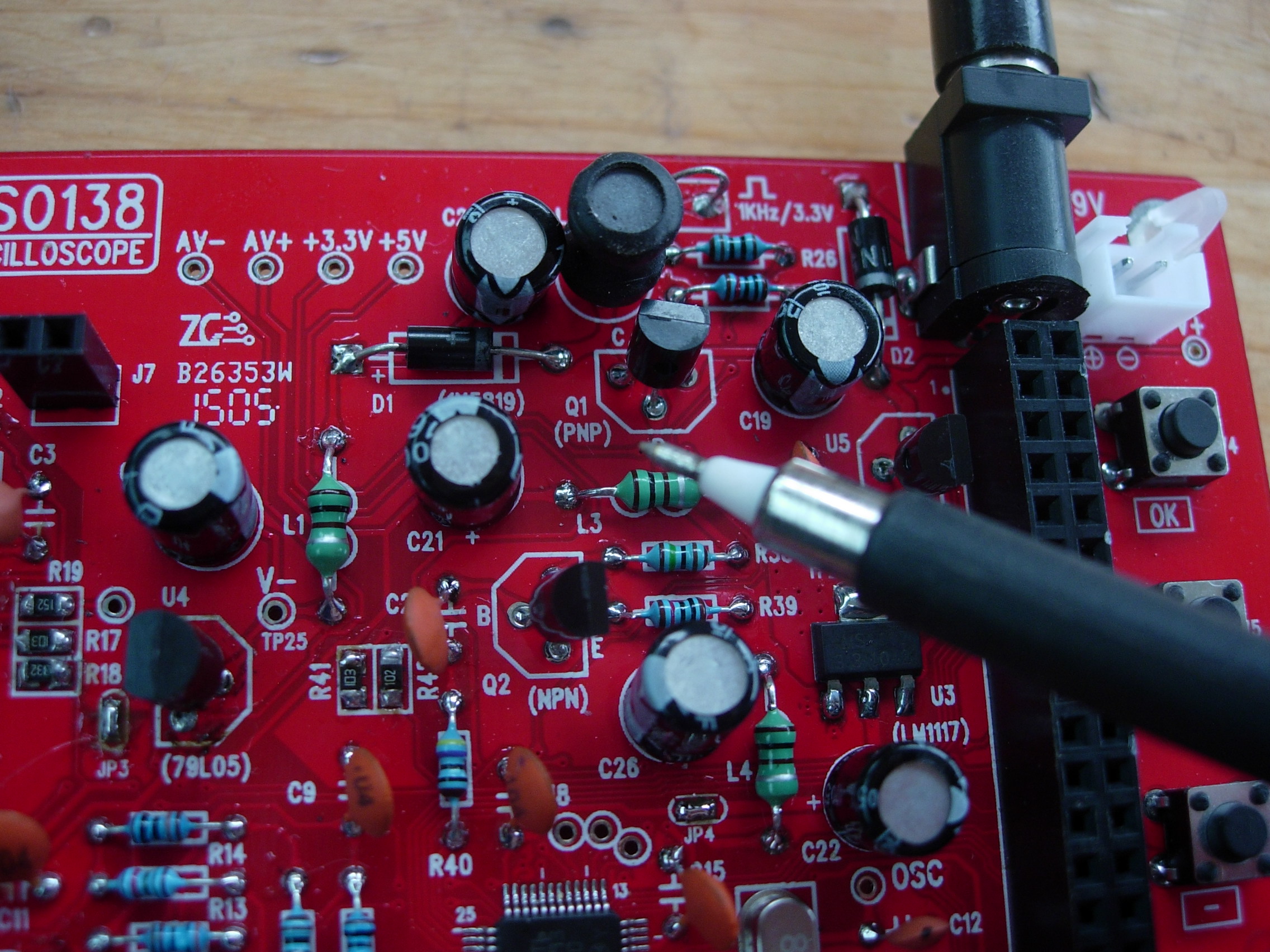

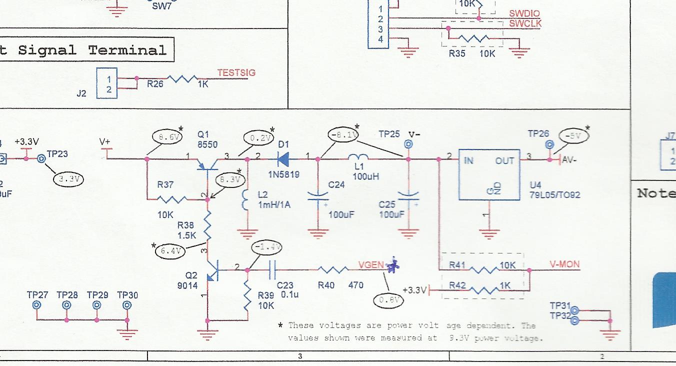

Did a little investigating today. CRO settings were probe 1:1, Time 10uS,Vert 1mV. The sawtooth was taken at TP25 V-. The other one is the probe just held near & betwean Q1 & Q2, to me there seems quite a lot of radiated energy from the switching side of the negative 5V supply

Not to tell you what to do, but it might be informative if you do not complete the -5v part so you can test to see if that is the noise source.
But with only 200kHz BW, when you get RF problems or ns or μs glitches, it wont help.:oops:
All digital is Analog and most Analog gets interference from or generates RF.
So all logic depends on RF principles and problem avoidance to work.
How's that for logic? :)
So we're screwed?
debe thinks the -5v supple may be producing lots of noise. This is possible.
If it can be replaced by a bench supply for a test it may prove fruitful.
Gotta know which circuit to blame. Hopefully one circuit.
