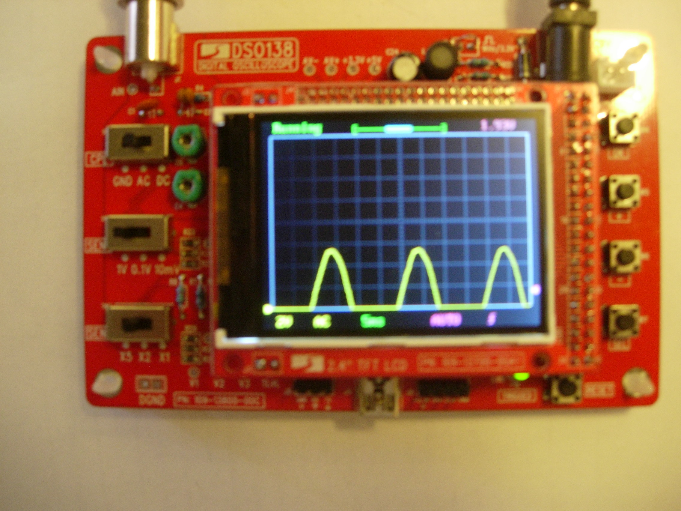

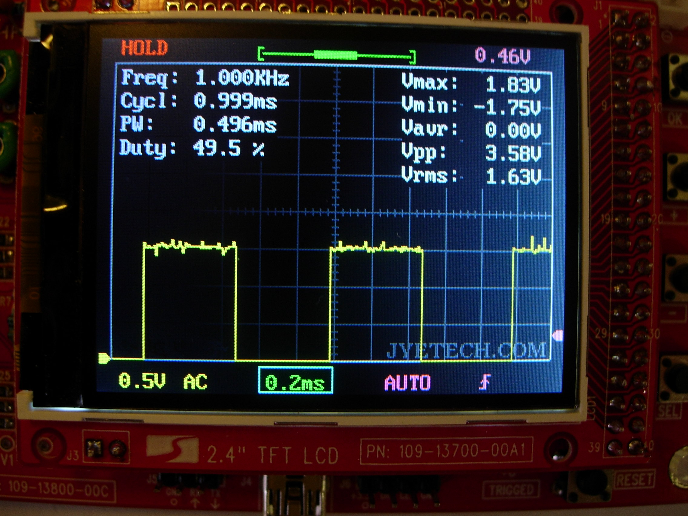

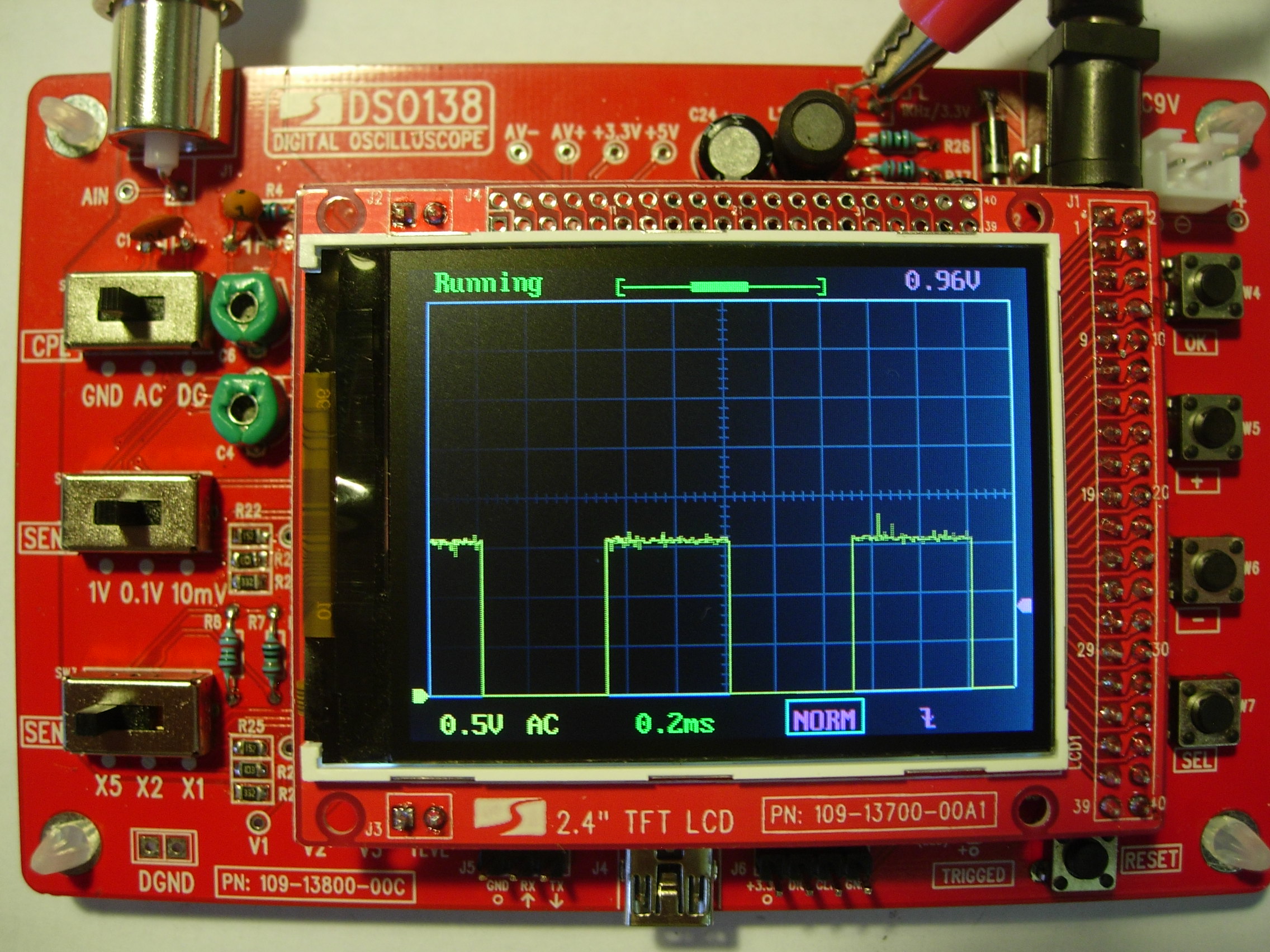

Posting a couple of pictures of the one iv assembled, with mutch difficulty due to surface mount components & my age. The sine wave is the local 50Hz mains, &
the bottom of the wave is cut off & I just canot get the zero line go to the center of the screen per the instructions. The square wave is the test sig & the same problem. What am I missing? Ive also found a seller in HongKong selling these CROs fully assembled for $8 more, so have ordered one to see if its any better. Prety mutch half the wave form is off the bottom of the screen.

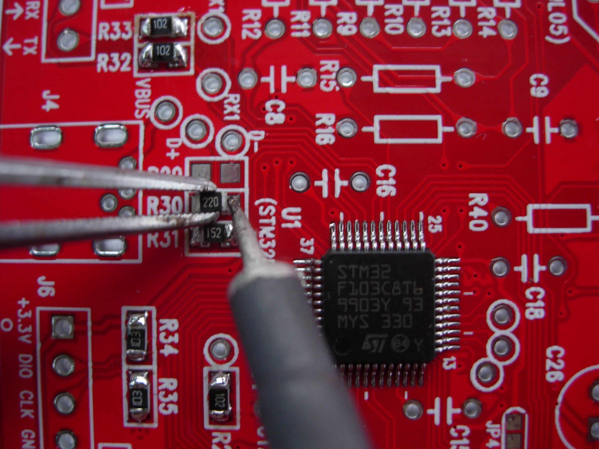

I'm 67 and could not find a tweezers when I had to deal with those 19 resistors. Used a tiny screwdriver to move and hold in place the buggers. Thick gooey rosin helped too.
Your soldering looks good.
I have been frustrated with the trace going off screen too. I have been able to move it up so far.
Is the trace set to hold? Looks like the input is on gnd. Perhaps the trace position does not work in that mode.

You're brave to measure your house voltage. Hope you used a x10 probe.

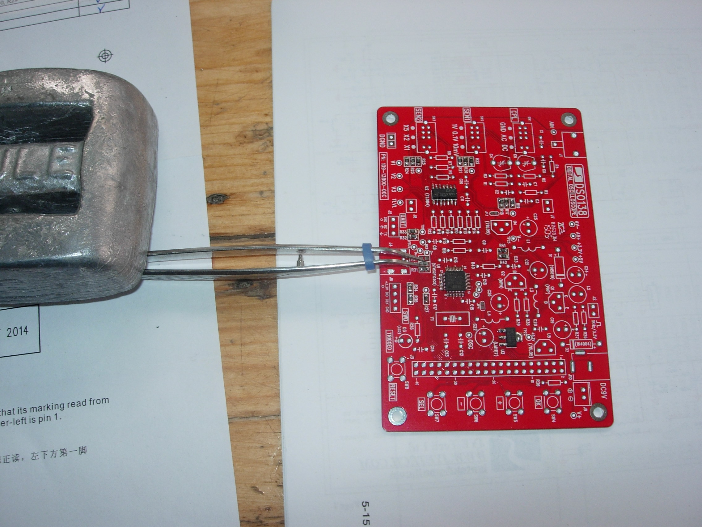

The mains was from a 3v ac transformer, & my soldering wasn't that good in some areas. Pic of soldering the chip resistor. Soldered the surface mount IC wrong way around, & managed to remove it with out damaging the solder pads. The replacement ICs I got had pin 1 marked with a dot, & were cheep enough bought 10 for $5 freight free. Yep im younger than you 66yrs.
