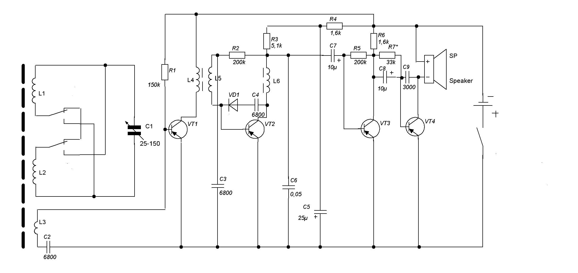

I don't think this is super-regen.
Where do you see a positive feedback and oscillator here?
It is a basic reflex circuit, with unusual detector (diode in series with capacitor). Here is the complete diagram:

No.
A "Reflex" circuit loops the detected audio back and uses some of the RF stages to amplify that, then separates the two again.
The regenerative feedback in that circuit would be loose coupling from L6 to L5.

There's so much wrong with that 'circuit' it's hard to know what it's supposed to be doing :D
However, as I see it, L6 is probably an RF choke, and it's 'supposed' to be a reflex circuit, feeding the audio back via VD1.
But presumably it's yet another non-working circuit he's found on some young kids webpage?.
Must say though I'm quite bemused by the tuning switching, switching two coils in series or parallel - I've no idea how well that would or wouldn't work, as it's not something I've ever seen done?.

Yes.
It IS a reflex receiver. L6 is not related to L5. L5/L4 is an RF transformer, L6 an inductance load of final stage of RF/first stage of audio amp.

You have to learn a lot, Nigel (well, at least you did not see a super-regen here! :) ). This is a famous (or infamous) circuit published in 1958 and it won a first prize on country-wide exhibition. Was reproduced by thousands of radio-amateurs (radio-hobbyists?). Kind of a legend. Strange implementation of detector and technically should not work. But it does. At least it did, and this is probably the most interesting thing. Current explanation (one of) is that this construction was adjusted for low quality components available in 1950th, with reverse current of up to 0.1mA. Modern diodes are way better and THAT might make it hard to reproduce today.
