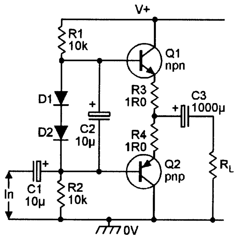

Have a look through this article, it explains or at least includes many of the design features and information others have already mentioned:

BTW similar circuit, no bootstrap, no negative feedback. Surgeon general should be mad at that Ray Marston :eek:

Thank you for the link, it looks useful.
BTW similar circuit, no bootstrap, no negative feedback. Surgeon general should be mad at that Ray Martson :eek:
I think you'll find that Ray Marsden never suggested that was a working or practical circuit, merely a demonstration towards making a practical circuit.
You might perhaps notice that 'circuit' has zero voltage gain?, plus the many other faults you've already identified.
You also might notice that it's not until figure 15, that he suggests 'practical amplifiers', which include bootstrapping and negative feedback (even if the feedback is a bit poor).
Sorry, he forgot to share his suggestions with readers of 'Cookbook'. When I see a schematics _with_ components values, I reckon it is practical. When I see just designations, like, R1, C2, Q4 - then it is a theoretical explanation/demo. Simple, eh?
f.e, this is theoretical illustration:
This is basic, but practical construction ( he even gives details of what type the capacitor must be):
