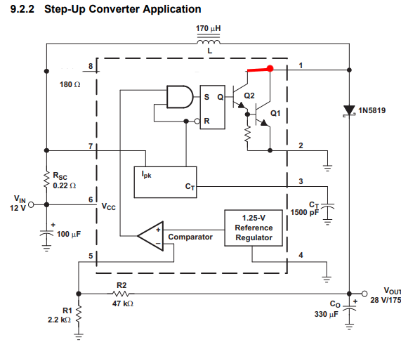

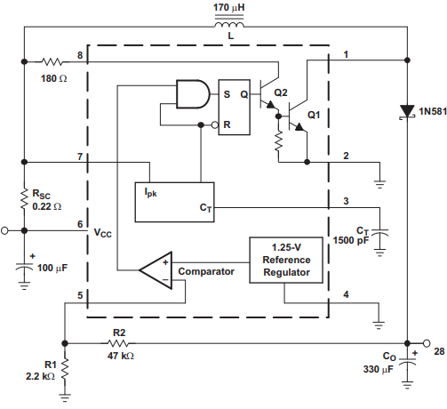

Two circuits below. One is Darlington where the voltage from Collector-1 to Emitter-2 is high (when Q1 is on) so there is power lost in Q1. In the other circuit power is lost in the 180 ohm resistor. The C-E voltage when Q1 is on is much lower. You have a choice.

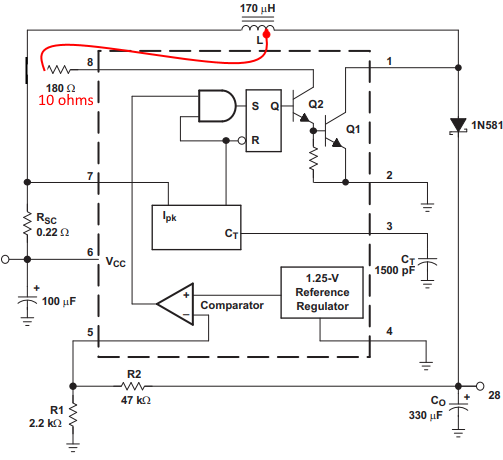

Another option: Left side of inductor is just below 12V. The right side is 0.3 to 0.5V. I tapped off the inductor at about 1 to 2 volts. Reduced the resistor to 10 ohms. Now Q2 has the same current but the resistor has 1/6 the voltage and 1/6 the power lost.
The VCEsat on page 6 looks like 0.65 volts more in Darlington mode which is just right.
The extra power loss in Darlington mode is almost exactly what is lost in the resistor. (at 1A)
