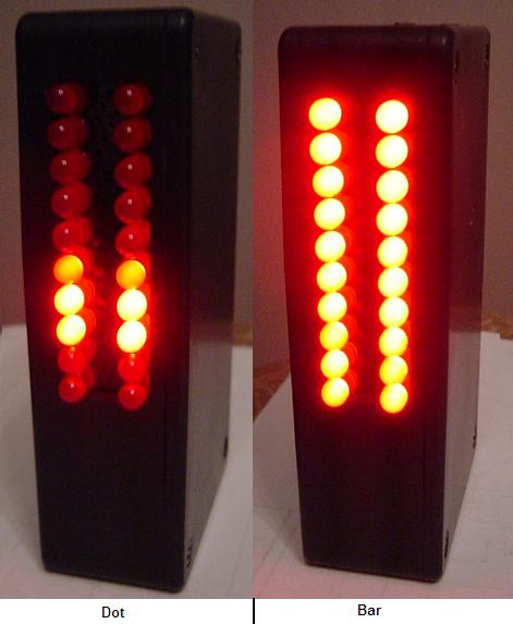

I didn't use dim, dinky little surface-mount LEDs on my latest project:
nice looking
I just suggested surface mount since the OP apparently is concerned about space, wanting an entire voltage readout solution no bigger than a 20 pin DIP
Thanks.
I had to use Veroboard on a diagonal to fit my project's LEDs tight together. I had to file a few of the LEDs' shoulders a little to make them fit. The display board and the electronics board interlock so the display board is secured without screws.
The bottom 1/3rd of the box houses a little "9V" Ni-Cad battery that lasts only about 20 minutes if all 20 LEDs are at their max 26mA brightness, and the box gets a little warm. It lights up a medium sized room at night. :lol:
