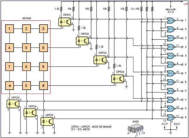

the problem is how can we seperate the buttos of the kepad
and another help;
the photo in the attached fikes
can any one tell me its purpose and alternatives

To answer your last question, the circuit shown decodes the keypad matrix switch connection to give the 0 through nine plus * and # individual output signals. It also includes opto isolators to electrically isolate the keypad.
If you don't need isolation then you could eliminate the opto isolators. But doing that inverts the signal so you would need to replace the NOR gates in the decoder with NAND gates.

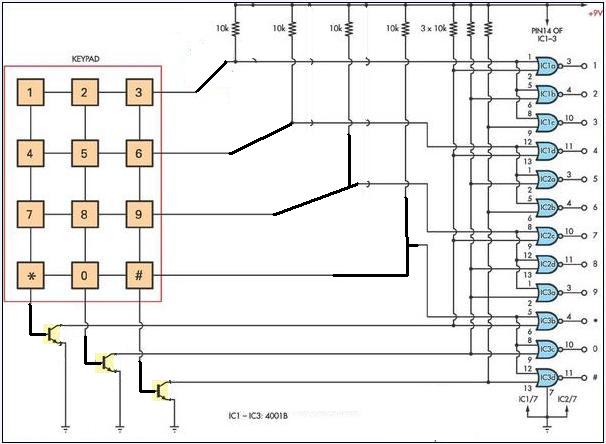

The keypad is not electrically isolated; it shares a common power supply. The optos are used to provide voltage translation to drive the logic. The row (top) optos may be removed, while the column (bottom) optos could be replaced with NPN transistors (base to keypad column pin, collector & emitter as per opto C & E), as per attached schem.
