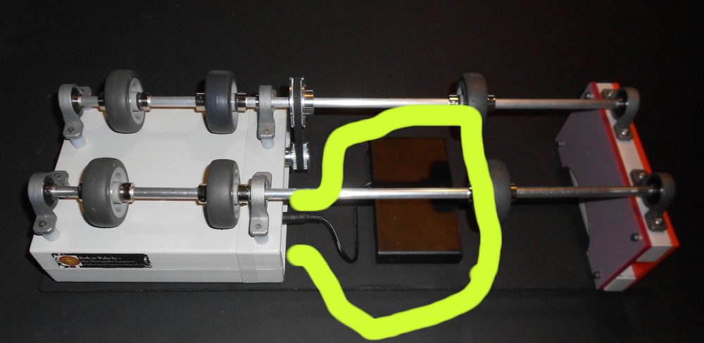

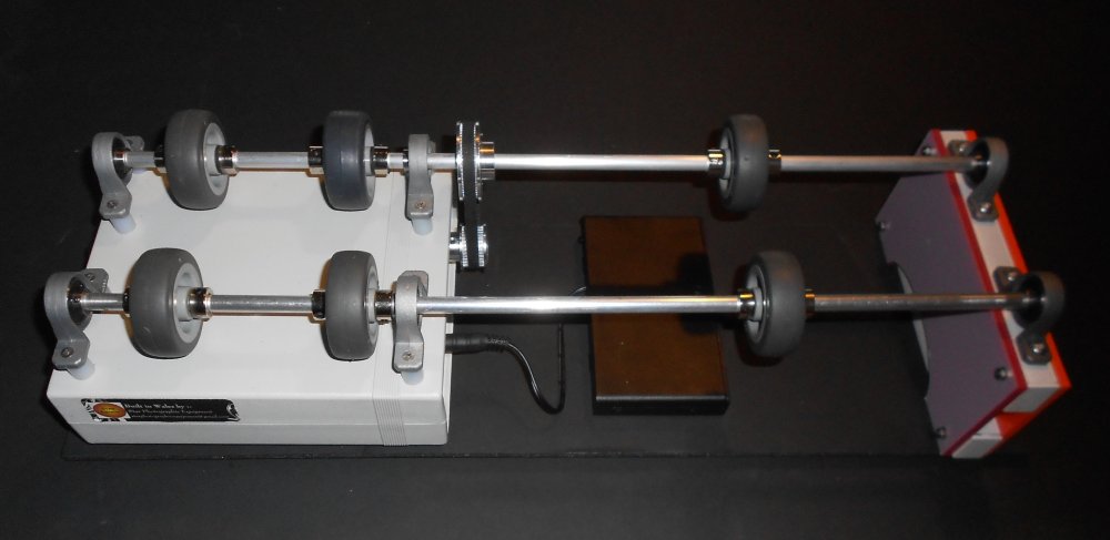

He is building a rotary film processor
He wants to include a TIMER (we have no idea.
Bought these
and
It needs to be able to start, run for a set time say 30 minutes and stop, 12v, HELP PLEASE, happy to return in wrong and buy the right thing, as there is NO wiring help we are stumped, AUTISM :( :(

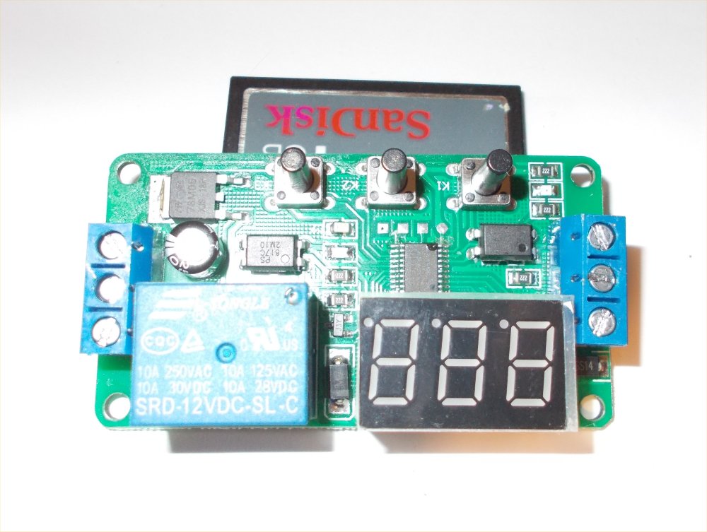

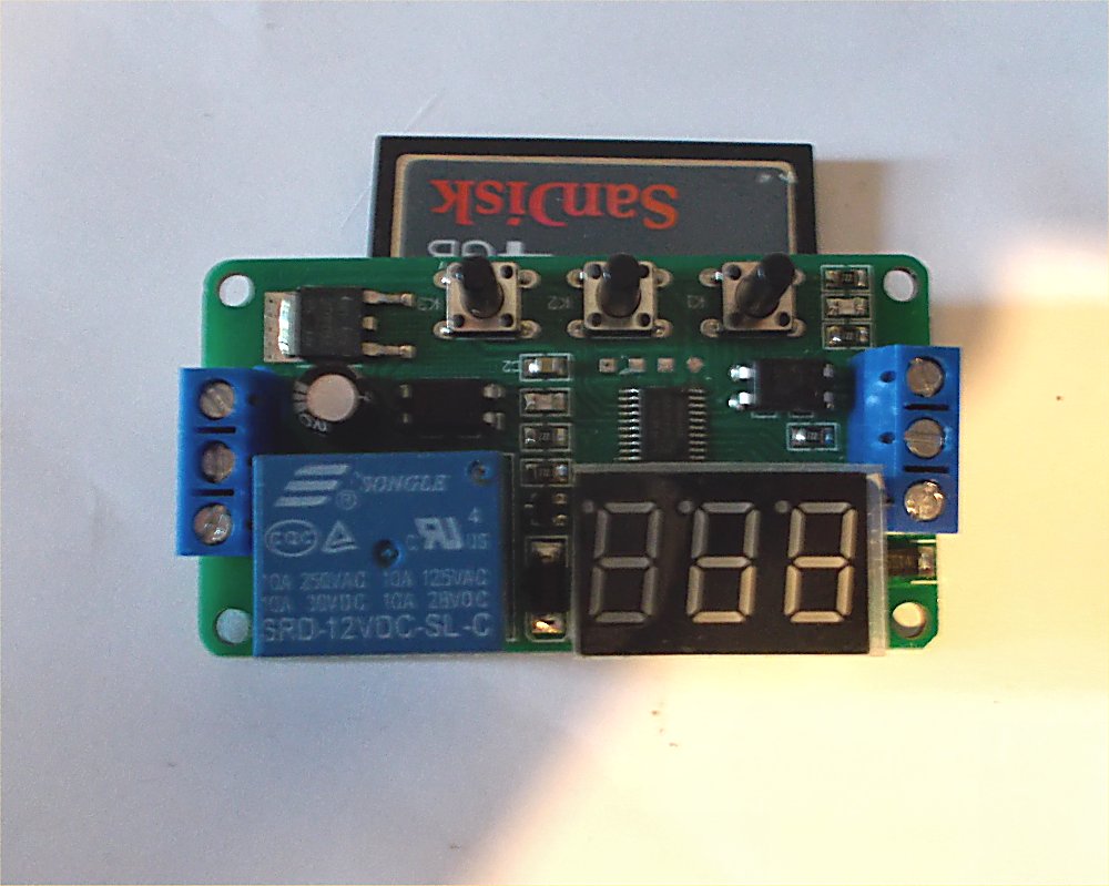

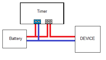

The first timer you list should do fine. It has the 12V input for the control circuit (blue connector) and output connector (green) to control one wire for power. All you may have to do is put an extra jumper from the blue + pin to one of the green connections. The other green will be the +12V out controlled by the timer.

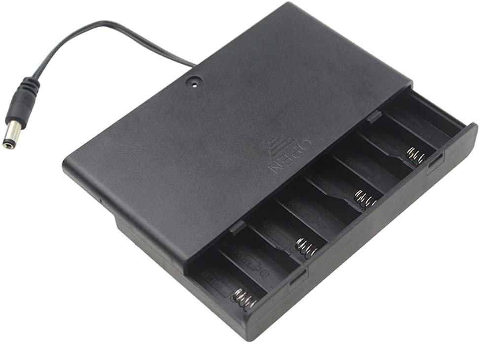

This all assumes your 12V has enough capacity to run the timer and run the device all at the same time. AA batteries do not have all that much capacity...
How can that help when I said it has a 12v supply you can see the battery "AA" supply plugged in ?????
I did not know what the other box was, there is no identification.

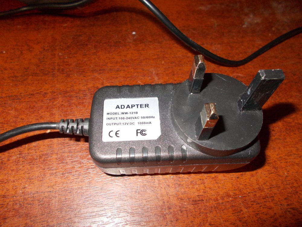

For something motor-driven that runs for long periods, I expected a mains PSU with 12V out.
Something like this, which would likely work and save the cost of batteries?

And how is that an AA battery?.
We both know that's an AA battery box .. .. . probably for 6 x AA batteries. If the motor is 12v it would run, albeit slower than expected ?

The timer you bought will work fine... Sagor is probably drawing a circuit up... All you need to do is separate
The positive coming from your battery box and route it through the relay connector... The other ( blue) connector is 12v ~ 0 volts... Personally I would unsolder the battery box and connect those wires to the blue connector, then run another pair back to the battery..

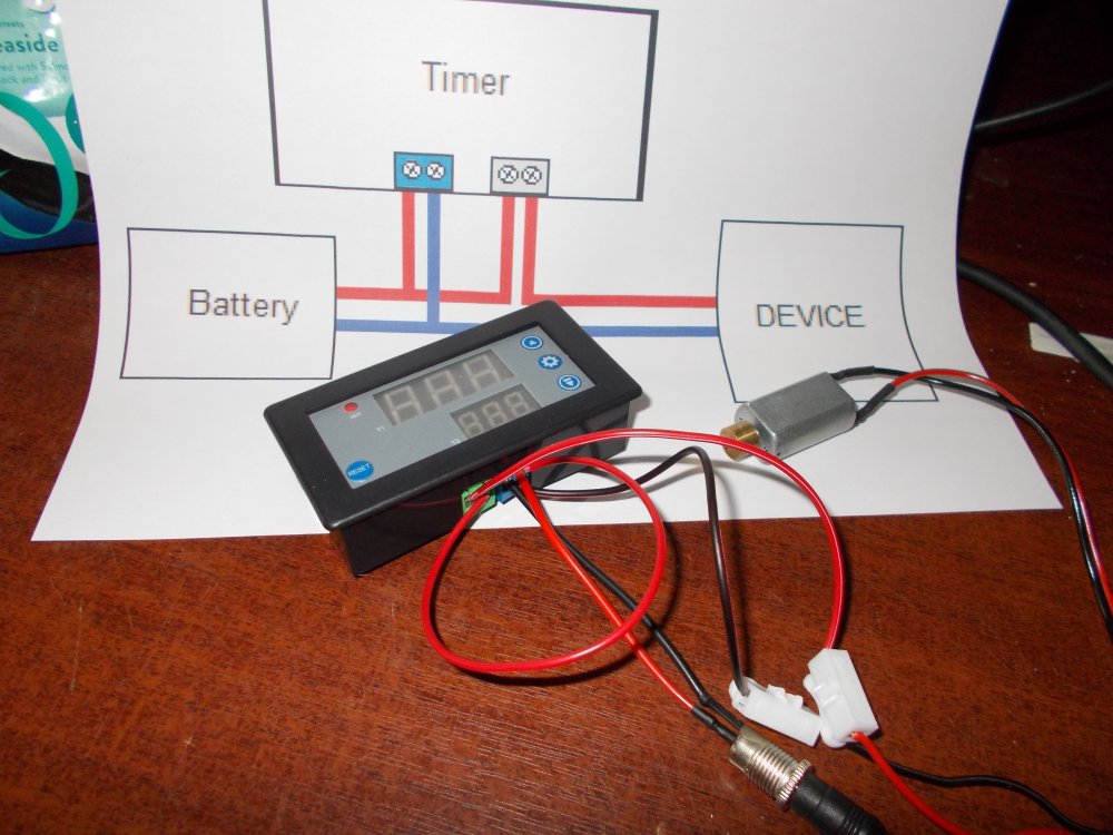

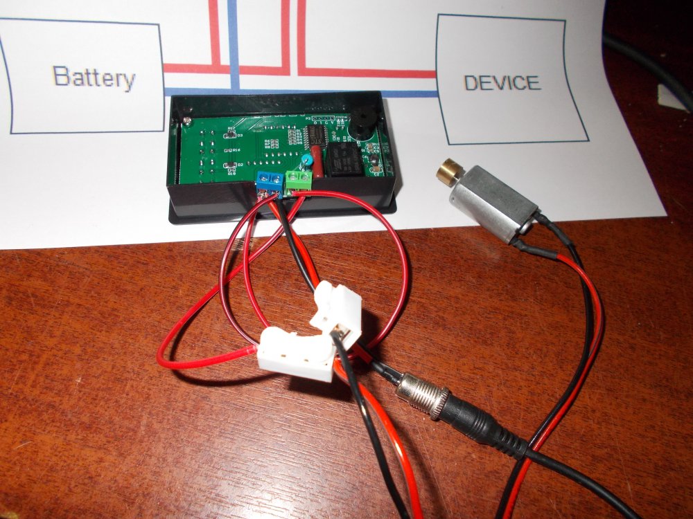

I thought I had done 100% what is shown all I get is a red light nothing turns on
Has to be me, thanks and sorry
