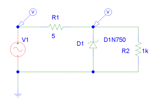

As far as zeners in ESD....
zeners have a reverse breakdown voltage much like most other diodes have a forward voltage. By placing a 5.1v zener in a circuit, you can latch a line to keep it from going above 5v or too far below 0v such as in the circuit below.

I think you used Orcad PSpice to do that, no? the 9th edition maybe... It's not that I don't know ANYTHING about diodes, but I wanted to know the relationship b/w them and the ESD protection system, which, I repeat, I don't have an idea about it...
