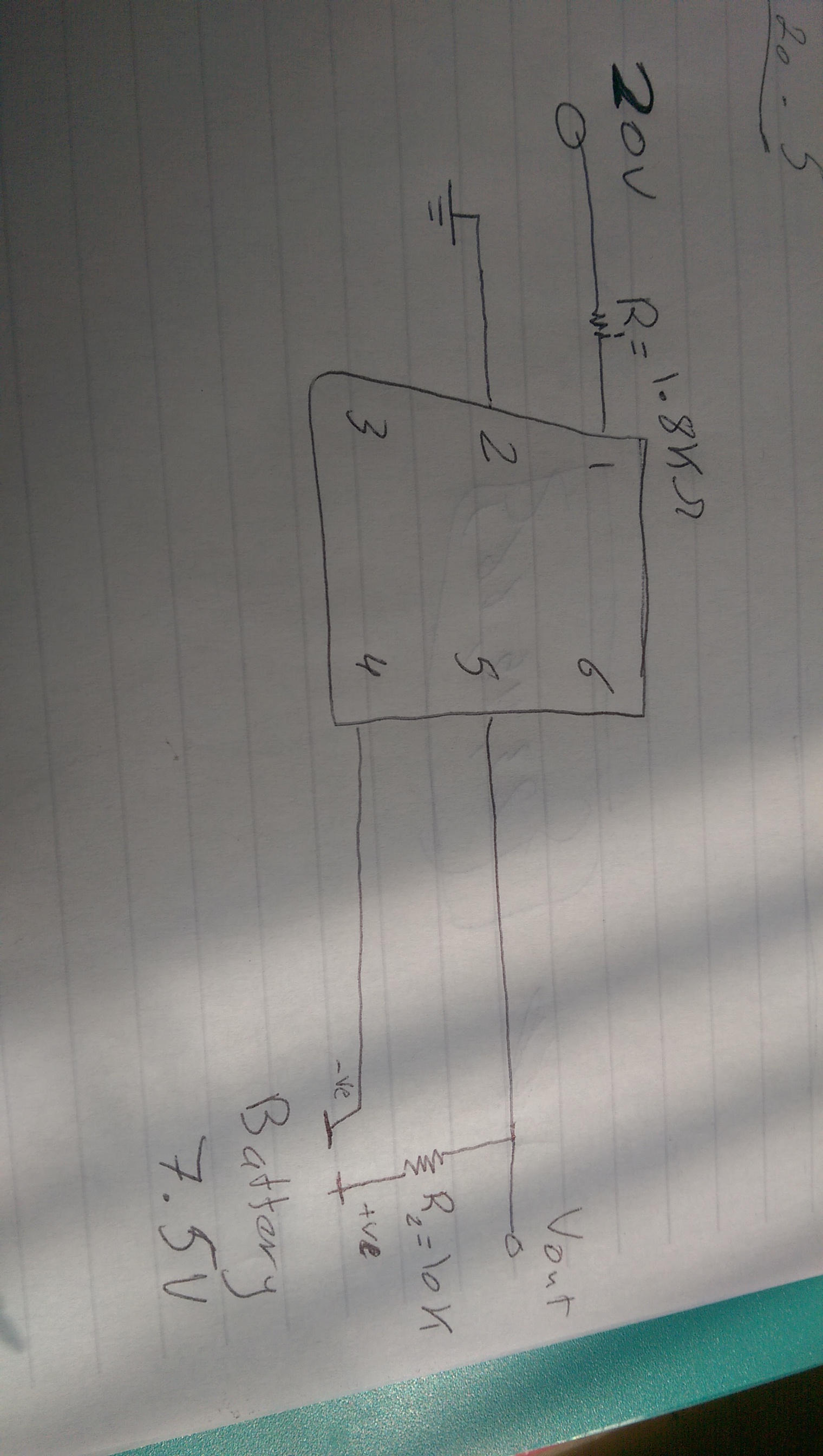

Hello people
Please help me
My circuit is this diagran.
I always get 7.5 V in the vout.
I think pins 4 and 5 never get connected for some reason
Your new schematic does not show the polarity of the 20V.
If pin 1 is +20V and pin 2 is 0V then the transistor should turn on and Vout should be low. If pin 1 is -20V then the LED in the optocoupler might be destroyed.
