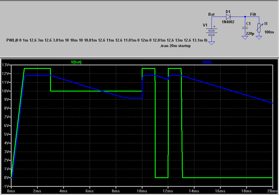

If this is an automotive application, then the diode prevents the capacitor from discharging backwards into the car's main bus during the times when the car's battery is pulled down during cranking. The capacitor charges to the normal battery voltage (12.6V) minus the forward drop of the diode (0.7V). If the battery voltage suddenly drops below 10V (i.e. during starting), the capacitor will discharge only due to the load current (100mA).
The rate of discharge can be calculated thus: Q = C*ΔV = I*t
Since the capacitor is initially charged to only 12.6-0.7 = 11.9V, it obviously can only supply 100mA for about t = C*ΔV/I = 220e-6*11.9/0.1 = 26ms until it completely discharges.
So, as a "filter", this thing is effective only for negative going spikes on the source side, and only for spikes lasting less than a few tens of us at that.
A picture is worth a thousand words:

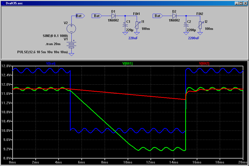

I have tried using this method to "filter" alternator whine. The alternator puts about 100mV p-p of AC on top of the battery voltage. Here I model it as a 1000Hz sine wave, although in real life it is really a three-phase, six-pulse full-wave rectified complex waveform. Note that at a 100mA load current, increasing the capacitor to 2200uF does a fair job of leveling the alternator ripple..., while the original 220uF doesn't attenuate the ripple much at all.

Mike - thanks for the new plot and it certainly appears the diode/cap does act as an effective filter with the 2200uF in place.
So how to calculate its frequency. Just taking the equation for calculating ripple and looking at a 3dB drop in Vs ripple it gives f=2*I / (Vs*C) but that seems to be for sine input. To calculate what you simulated - a ripple on top of the DC eludes me and it is just that part that is of interest.

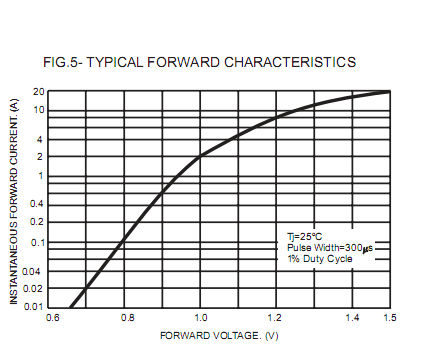

Mike - I was looking at the plot you last posted and it shows the drop across the IN4002 as 0.8 volts? That seems high? Is it normal.
Q
Q
Thats normal for a silicon diode, it can be from approx 0.65V thru 1V depending upon the current thru the diode
