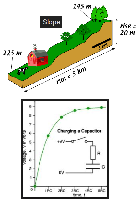

It's not a slope/ramp, its a straight Line ( DC voltage )
When you press the active low reset button, the straight line ( DC level ) goes down to zero volts straight line, when you let go of the active low reset button, the straight line ( DC level ) starts rising up still is a straight line rising up at a different voltage very slowly until it reaches + 5 volts
A slope is a line that rises up.
The voltage of a charging capacitor rises up, making a slope.
