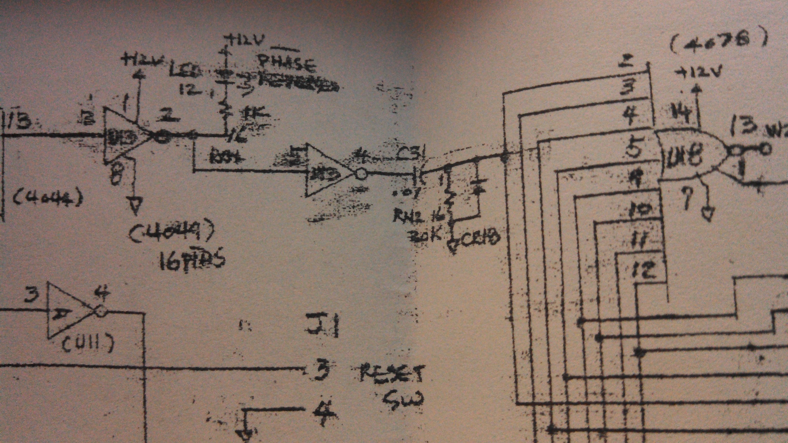

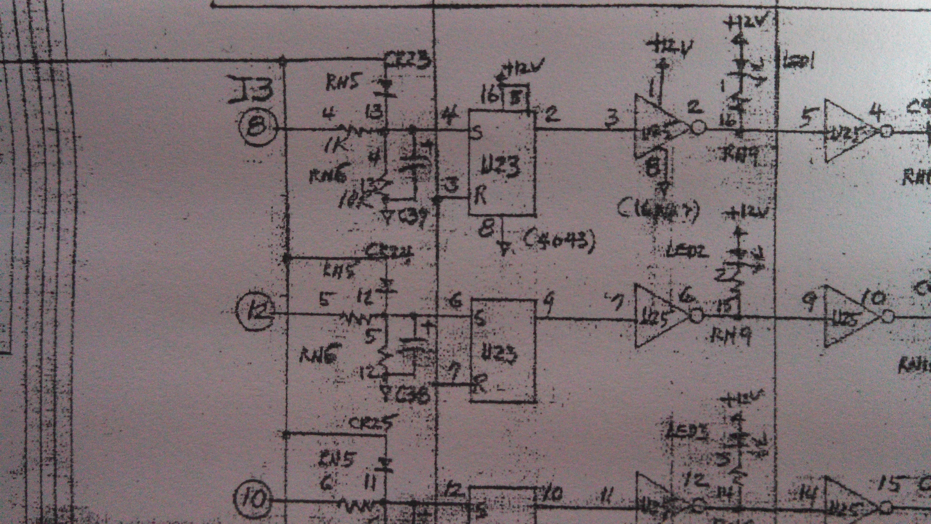

At my work they use pull up and pull down resistors for every input and output for each Logic IC chips, logic gates, any reason why? all i can think of is if there was noise on the inputs or outputs
I do see schmitt triggers and hex schmitt inverters have a RC network either on the inputs or outputs, its either a RC high pass or RC low pass, what are they used for?
The output is either a high or low state, but what does those RC networks do?
If there was noise on the inputs or outputs to cause the IC to have false transitions or logic states
I'm guessing pull up or pull down resistors correct and force the false logic states to not happen
That is hard to tell without a schematic, but maybe it is a "tradition".
The RC filters may be used when you have a high speed logic IC driving a long trace to reduce EMI, because it slows down the rise/fall times at the transitions.

Like I said, the pullups function depends if the I/Os are going to the outside world or are between chips.

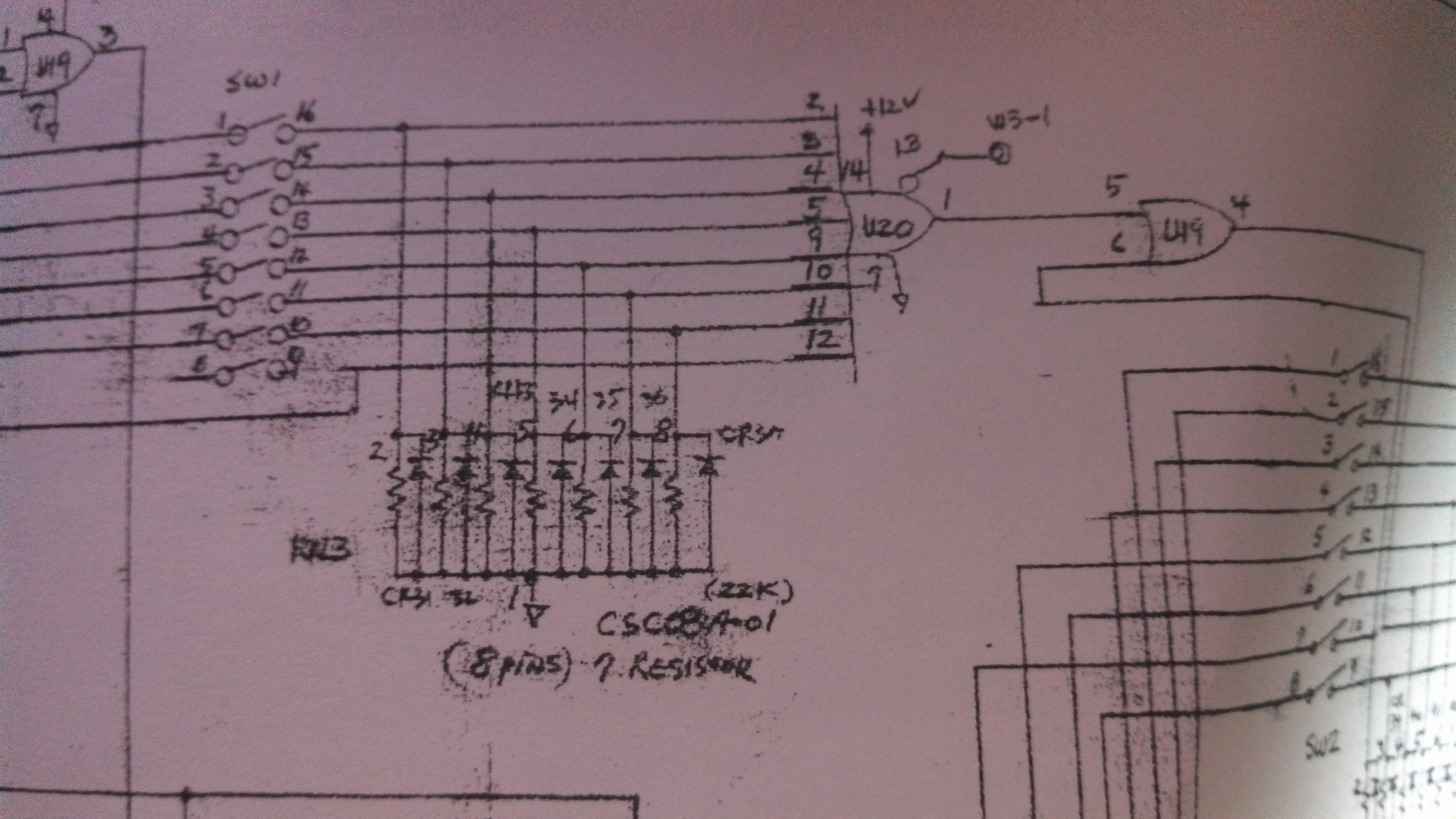

That looks like some really ancient technology. The eight diodes are used to protect the IC from voltage on the input that is below ground, the resistors make a low state when the switch is off.

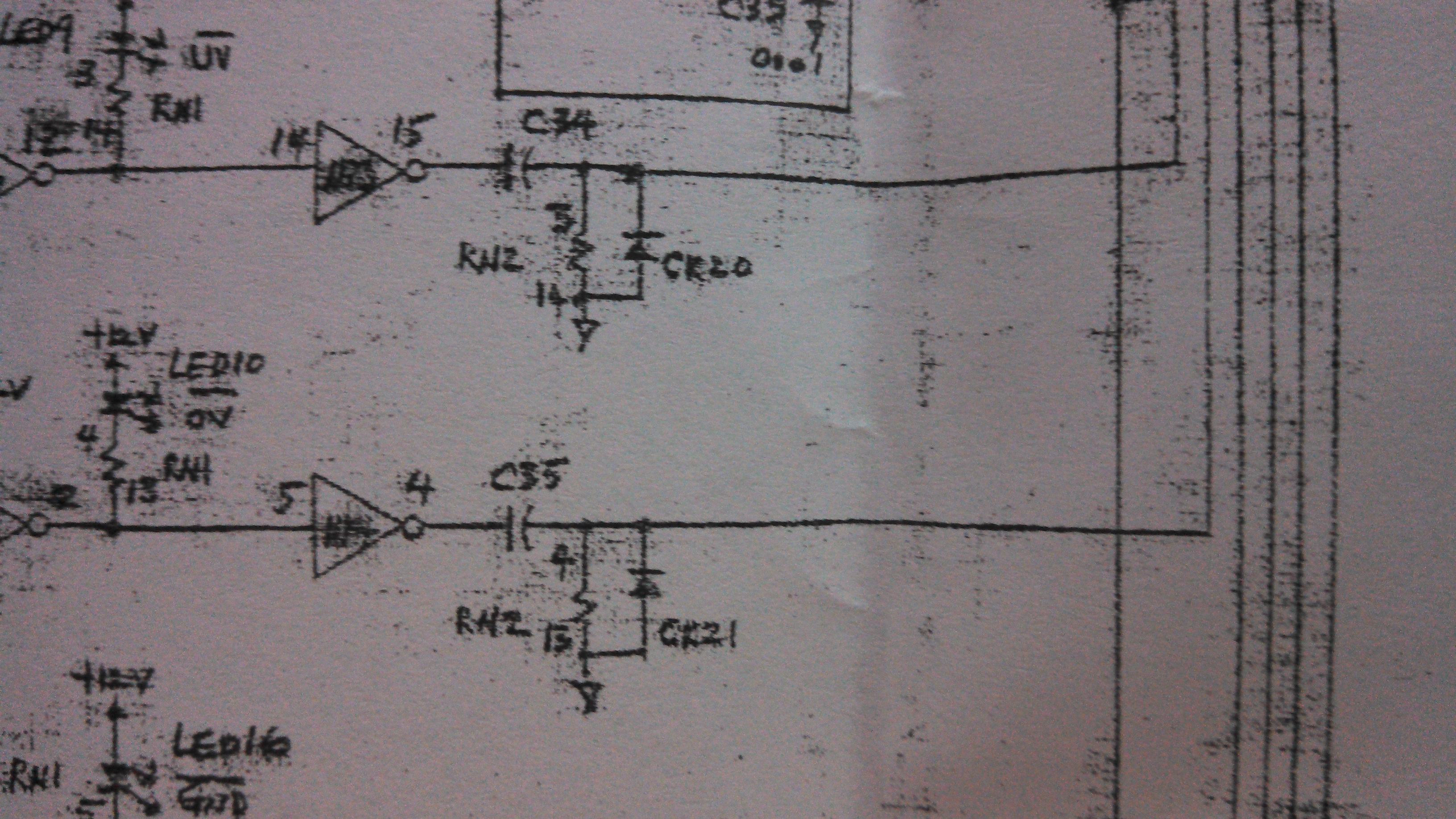

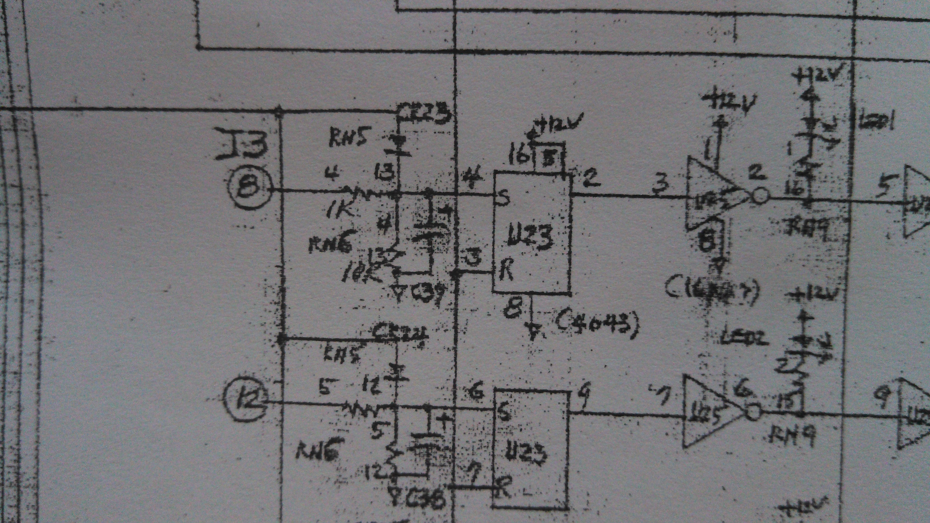

The RC network with the diode is an edge detector, it provides a short high pulse when the output of the schmitt trigger goes from low to high. The diode againg protects from negaitve voltage when the schmitt triger goes from high to low, creating a path to discharge the capacitor.

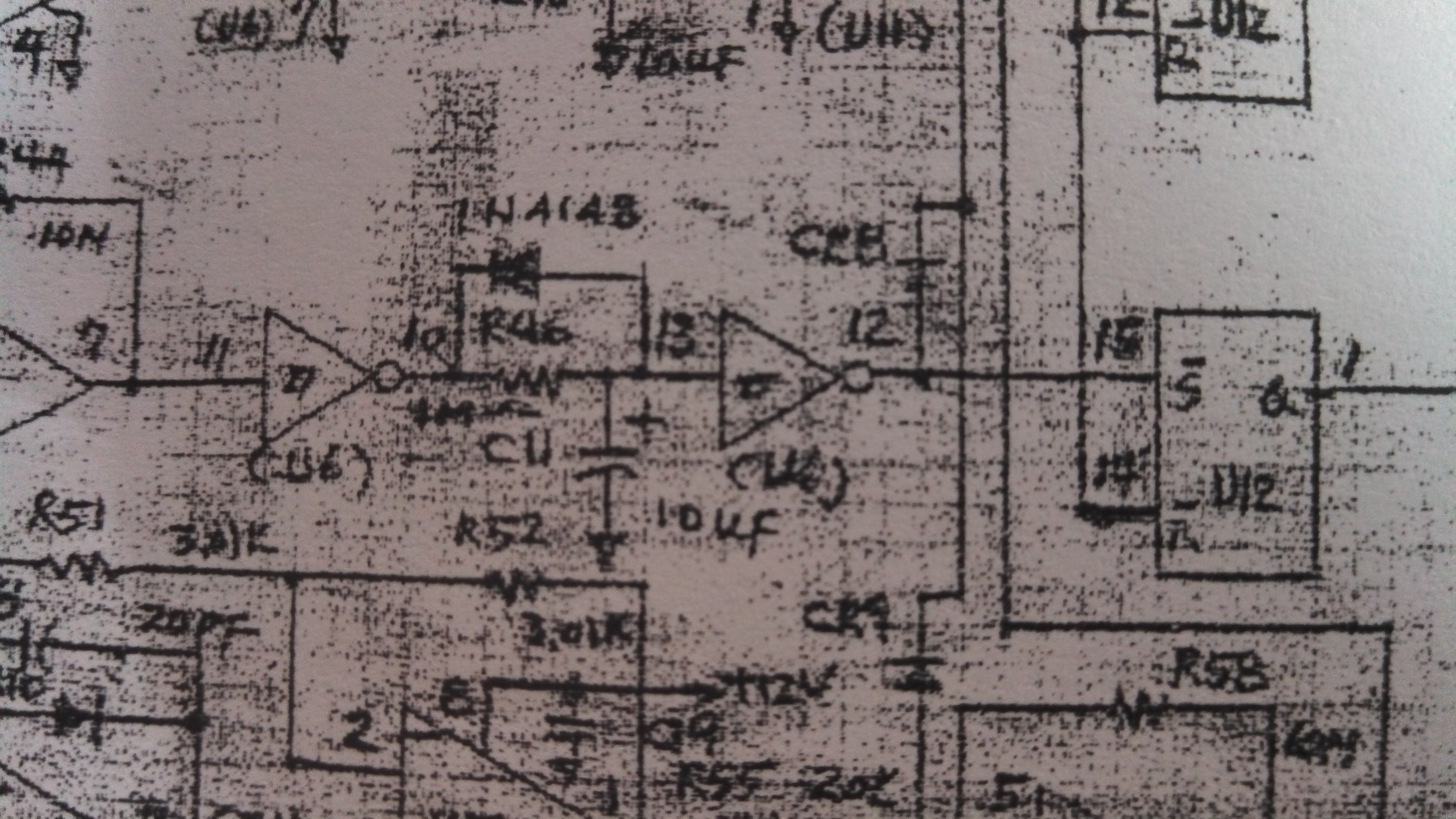

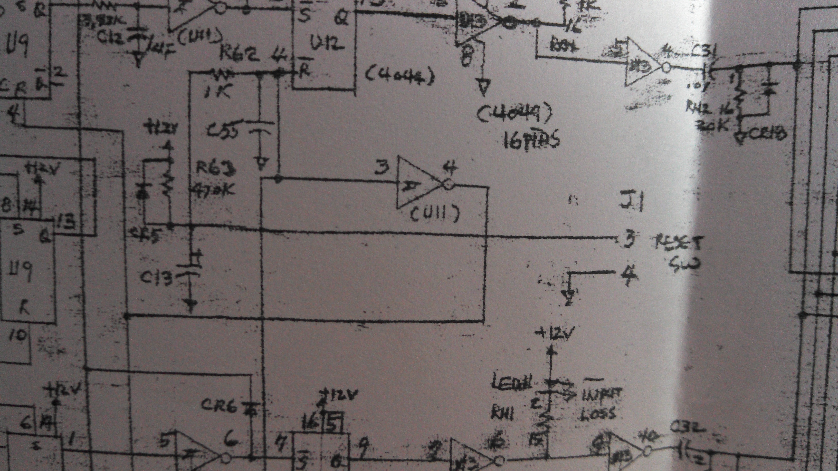

In the last one I see two RC delay setups, and something that looks like a power-on reset pulse generator.

The eight diodes are used to protect the IC from voltage on the input that is below ground.
What u mean below ground? how does it protect the IC , its a multi pin NOR gate
The 8 diodes do what i'm confused

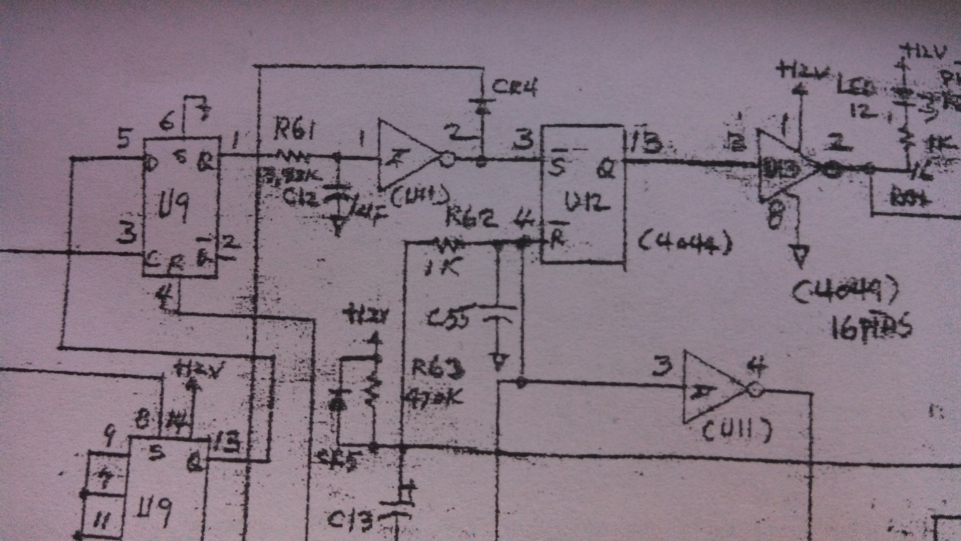

Yes the pulse with is like 2% to 5 % on the HIGH state going to the RESET pin
Here is a picture of the RESET switch

The capacitor C13 charges slowly causing the Reset signal to be low until the capacitor has charged a few volts. See pin 4 of U12 that is marked R with a line over it? It is called "R-not" so it is reset when it is low and the datasheet also says so.
The RC networks in your other sketches are also simple time delays.
Yes the reset button is a momentary switch. When it is pressed it cause the voltage to go low but then the voltage rises up to +5 volts.
why did the designer want the reset switch to have a time delay or have the voltage rise up after the reset switch has be pressed? When the rresets switch dc voltage is rising from low to high after its been pressed what is this called
Most circuits require a certain minimal lenght of the reset pulse to insure a correct reset, so this circuit does that using a slowly charging cap.
Any reason why the reset needs a time delay?
