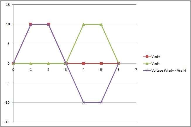

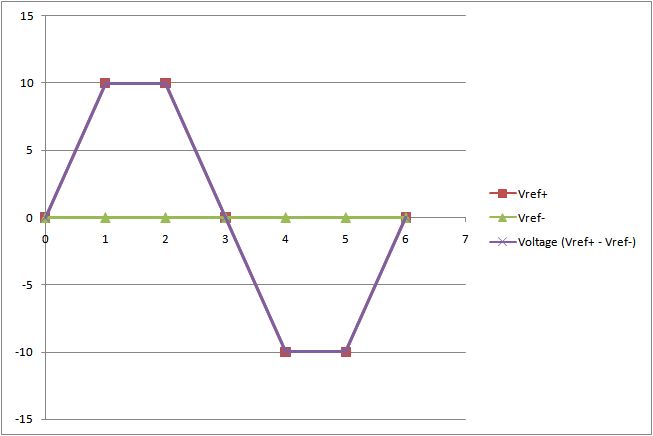

Sorry, maybe this will help:
I have a servo motor amplifier which accepts a differential voltage as a velocity reference. I am trying to create a circuit to control the drive. I will be sending the voltage (velocity) and watching the encoder coming back to control the position of the motor.
I have just hooked up an instrumentation amp (to get both the gain and the offset. It works ok, but I wanted to try to do something where i can use the fault feature of the microcontroller. It allows an override of the pwm to pull the pins to a pre-defined state (5V or 0V). I would like to pull to 0V.
There are two possibilities:
1. both signals vary positively with respect to gnd;
Time Speed Vref+ Vref- Voltage (Vref+ - Vref-)
0 0 0 0 0
1 2700 10 0 10
2 2700 10 0 10
3 0 0 0 0
4 -2700 0 10 -10
5 -2700 0 10 -10
6 0 0 0 0
2. only the first signal varies;
0 0 0 0 0
1 2700 10 0 10
2 2700 10 0 10
3 0 0 0 0
4 -2700 -10 0 -10
5 -2700 -10 0 -10
6 0 0 0 0
The values are not discrete, see attached to avoid confusion (x-axis is time, y is voltage)

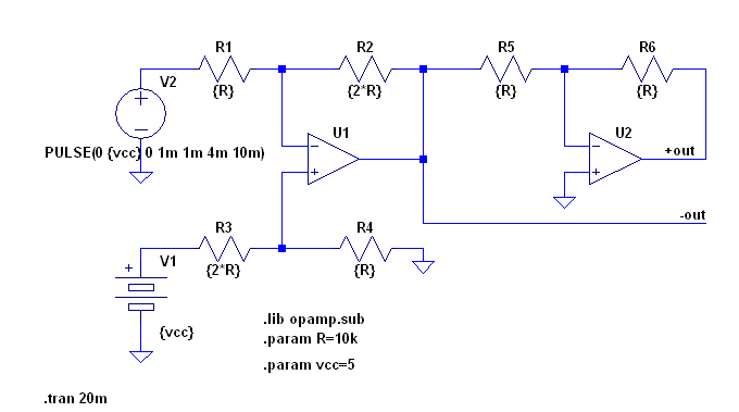

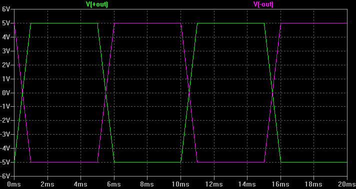

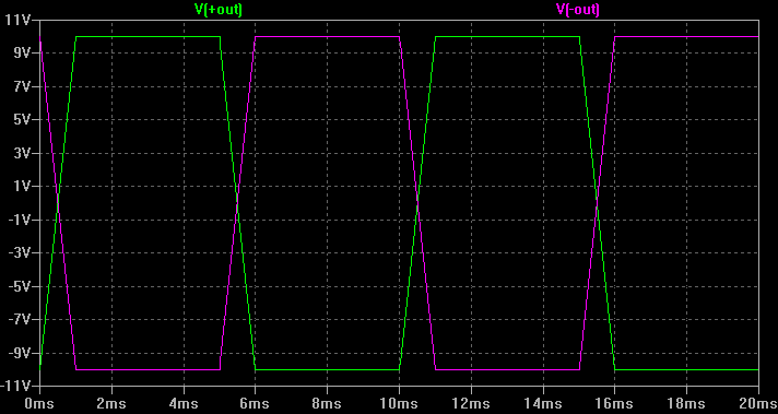

Why can't you do it like this:
  • single-ended to diff.asc
Looks promising, what did you use to simulate this? What are the values of the outputs when the input signal is zero?
I used LTspice (SwitcherCAD III) from Linear Technology. It's free.
When PWM=0, +out=-5, -out=+5. If you want them to both be zero, you have to somehow distinguish between a valid zero volts and an invalid zero volts. Now, if PWM=0 and vcc=0, the outputs will both be zero. So, if you can guarantee that the PWM is always valid when vcc is on, you're OK, except maybe during the vcc transition.

Which was exactly what I proposed, but without the diagram - and why I asked what output you required?.
One schematic is worth several words.:D

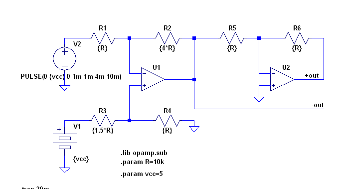

EDIT: I just realized the signal levels in the first schematic I posted are half what is required. Here's the correction.
Actually, no it wasn't. If vout- is -5 and vout+ is +5, the net is +10 and vice versa. It was right.
which I do
which i don't know how to do.
The transistion is a problem, it causes the motor to jump, b/c it sees the 5V prior to the pwm. so what i can try is the 5V from an output pin.
which I do which i don't know how to do.
That might work. If you are lowpass filtering the PWM prior to going to the op amp, you should put the same filter on +5V. If you are not filtering the PWM, you will need to pay attention to op amp bandwidth and slew rate.
