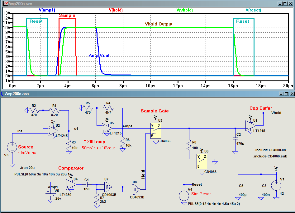

This circuit would be an option for an amp and sample and hold.
It removes the 2.4V offset from the output signal.
I am assuming that the output signal of the amp will always
be greater than about 5mV in order to trigger the comparator which generates the 'hold' pulse.
In practice the Reset circuit is not required, unless you want to have a 'zero' sample ref for the circuit.

The circuit you sent works just fine!
Thank you very much!!

I have been comparing the two OPA datasheets, it looks as though the AD8072 should work OK.
The coil sense should be such that the negative 'end' is connected to 0V and the coil end that produces the positive output goes to the OPA input.
You CANNOT make a hybrid of the two circuits.!!!
I dont understand what you mean you 'cannot see the negative pulse'.??
You originally stated that is was a positive going pulse that you wanted to amplify and integrate.?
This statement dosnt make any sense:)

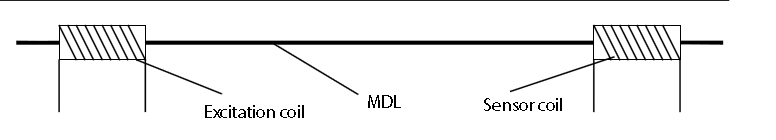

The MDL is actually a ferromagnetic ribbon. When in some place up or down of MDL someone approaches a magnet then at this spot, on MDL an elastic pulse will be produces and its going to travel to both directions of MDL. I
If at one spot, i place a search coil then i get the Vpp of the transmitted pulse. The Vpp is between the positive and the negative pulse of the elastic wave.
Don't you worry. You don't insult me!As i said i do not know a lot about electronics but i try to follow ( i am aware of the theoretics but in action i do not get along! )

1-The sensor coil will be placed so that the coil length is along the axis of the MDL.
2-If a magnet is passed close to the MDL then an elastic wave will travel towards the coil and to the opposite direction as well. So, the whole voltage that the coil will detect will be at about 50mV.
3-The place(height from MDL) of the magnet will determine the magnetic field. If it approaches more the MDL, different voltage will be seen. It doesn't matter which POLE, as long as magnetic field exists.
4-The whole magnet-story, is the general way that an MDL-sensor works. In my circuit i will not have any magnet but i will detect changes on magnetic field with some other way.So, it doesn't matter the type of magnet but the general idea.
At the image attached, you can see the basic idea of MDL. You have an excitation coil (or a moving magnet) which produces elastic wave which travel to both directions. There is a sensor coil, which senses a Voltage(of elastic wave). If you change the parameters of excitation coil (or magnet for example) then different elastic wave travels, so we get different voltage at the sensor coil.
So, as the elastic wave has positive and negative pulse, if we ground the coil, i suppose that we could not sense the negative pulse and we would take only the positive pulse peak.
I hope that this helped
