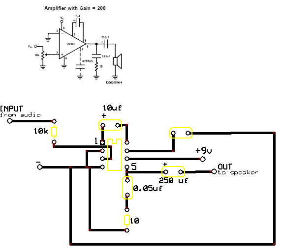

Hi, I have been having problems reading schematics, but I think I am getting the hang of it now. Can you please take a look at the schematic and see if I have everything connected correctly? I used Express PCB to make a dummy model of what I would put on a breadboard. (Its not how I would put it on a PCB, just to see if I connected everything correctly) Also can you tell me what I sould do for pin #7 where there is the dotted line, a capacitor, then ground. Thanks a lot!

There are several errors.
The 10 k resistor on the input should be a 10 k pot as shown on your circuit.
There should be a 4k7 resistor between pin 2 and the track you labelled as - , ie. gnd.
The cap connected to pin 7 should be 0.1 uF according to the data I have. They also state that it is optional.
There should be a 0.47 cap in series with the pot at the input.
I would also add a 10 uF bypass cap between pin 6 and gnd

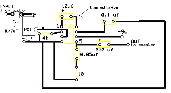

Thanks for the help! Does this look better? I appreciate all of the input!

Here's the answer to ljcox's suggestions, and change the obvious 4K to 4.7K.

I agree with mstechca's corrections. The 10 k pot has 3 pins as mstechca has shown. You were showing it as a resistor. But it is a potentiometer.
Also, you have not included the 10 uF bypass cap that I mentioned.

A 0.1uF to 10uF supply bypass capacitor provides a high frequency low impedance for the power supply to keep the amplifier from oscillating at a high frequency. A bypass capacitor with 470uF to 1000uF holds up the supply voltage when the internal resistance increases of a battery running down.
All IC circuits need a supply bypass capacitor.
The LM386 has an input bias current of only 0.25uA so a 4.7k resistor isn't needed at pin 2. The manufacturer shows pin 2 connected to ground.
A 47uF capacitor from pin 7 to ground reduces output hum from full-wave-rectified power supply ripple 150 times. Any more than 47uF doesn't make any difference.

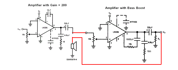

Will the circuit work fine without the bypass capacitor? Theoretically can you connect the input of another amplifier circuit to the output of that circuit to make the amplification even greater? (look at the attached picture) Thanks

The 1st LM386 has a gain of 200 and is designed to drive a speaker, not a volume control. It has some noise output. The 2nd LM386 amplifies the noise from the 1st one 20 times. The output will be HISSSSSSS.
If you need a high-gain preamp then use a low-noise audio opamp.
Why do you need so much gain?
The 250uF capacitor coupling the 1st amp to the second has a high value for driving an 8 ohm speaker. Only about 0.1uF is needed to drive the 10k volume control.
Your circuit doesn't have a supply bypass capacitor so both ICs will probably oscillate at a high frequency.
The "bypass" capacitors in your circuit are to reduce mains hum. If your supply doesn't have ripple then they aren't needed.

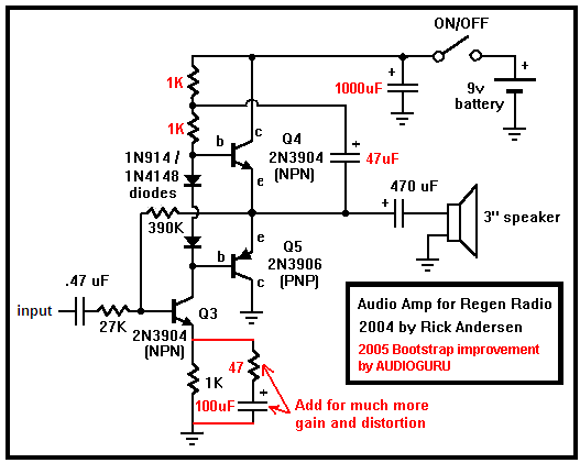

It depends on how you want to build it. Harry's homebrew homepages has a section on audio amplifiers in his transistor biasing section (under reference, and building blocks I think).
What he shows is a transistor version of a power amplifier, and it works quite nicely! In fact, it worked so nicely even under stressful conditions, that audioguru recommended that I omitted the 22 ohm resistor between the PNP's collector and ground!
MStechca,
An LM386 produces 0.5W with 0.2% distortion. It has about 20 transistors and costs $1.19 in Canada.
Your amplifier produces 0.3W with very high distortion. Its 3 transistors total cost is $.48 in Canada. Adding a resistor and a capacitor to bootstrap it and another diode will reduce its 40% distortion to 4%, and increase its power to 0.4W.
