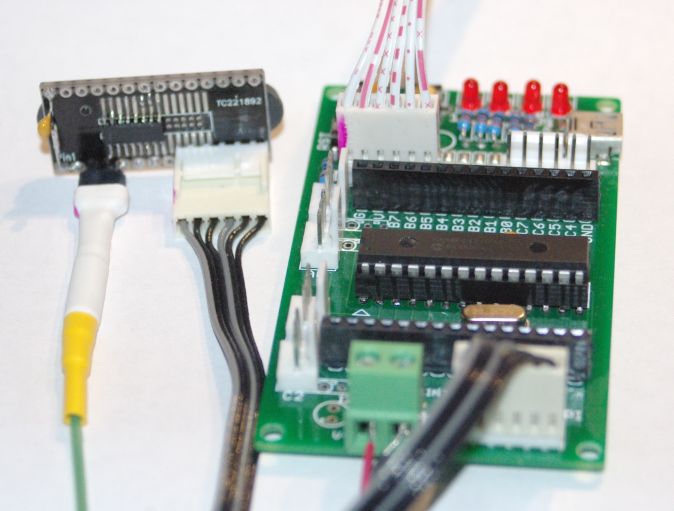

You might look at my TAP-28 board. I designed it for similar reasons but with a little different philosophy. Most of what I do involves hooking up some small amount of stuff to a PIC, such as a sensor or a breakout board using I2C or UART coms. I designed the board to be cheap, without a lot of extra features so it could be dedicated to a project and with connectors for the things I'm likely to connect. What I've ended up with is this:
  • 3 6-pin connectors, 1 for ICSP, 1 for UART and 1 for I2C/SPI. Each has 4 port pins, power and ground. They can be used for the hardware function or as general -purpose port pins.
  • 4 3-pin connectors, 2 with ADC inputs, 2 with PWM outputs. Each has power and ground in addition to 1 port pin.
  • 2 parallel SIP connectors with all the port pins, power and ground so a daughterboard can be added for additional functions. An example is a daughterboard with a UART-USB adapter for serial coms to a PC...which is someplace between here and China at the moment.
  • The board also has 4 LEDs and 2 pushbutton switches for general purpose use.
The result is a flexible board that's cheap enough to embed in a project without worrying about the cost. It works really well for stuff like this as connectors are used for interfacing to any external parts instead of a rats next of jumpers.
The picture below shows the TAP-28 board connected to a thermocouple circuit I'm working on which is interface via I2C.
http://www.clever4hire.com/throwawaypic/
Jon

Thanks Mike,
I designed the TAP-28 because I was either spending a lot of time soldering up a circuit on perfboard or using more expensive dev boards for applications where I wanted a simple PIC circuit. Building a perf board always takes longer than it seems like it should (especially if there's a short or something ends up in the wrong place!) and dev boards have a lot of features I don't use and not the ones I need.
