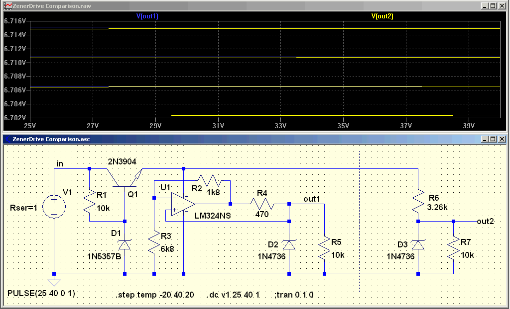

Stage two is the precision voltage reference, for lack of a better term.
I am not sure if this comment was directed to me, but I do understand the purpose of "stage two", what has me scratching my head is the op-amps wrapped around the zener diode.
At a first glance, it appears that the diode is just being driven by the output of the op-amp. Why?
Looking again, I thought that it may be a means of providing a constant current drive to the zener. If it is that, I am not seeing how it is supposed to work.
I dont think that I have ever seen a configuration like that before.
As I understand stage 2, the opamp + zener + voltage divider at the op-amp input behave in a similar way to an 'amplified diode'. If the divider ratio is n, then the opamp output will be n x zener voltage and will also be a relatively constant voltage drive for the zener.
Edit: That said, I don't think the end result would be much more accurate than simply driving the zener from the main power supply via a resistor.
alec_t
That makes sense, or at least it would in this case if the output from the voltage reference circuit was taken from the output of the op-amp, rather than from the junction of the zener and its series dropper resistor.
I agree Jim.
Out of interest, here's a simulation comparing the zener voltage obtained by using the stage 2 arrangement and the simple single-resistor drive arrangement I mentioned. The resistor is sized to give ~ the same zener current in both arrangements. The plot shows zener voltage where Vin goes from 25 to 40V (x-axis) and temperature is stepped from -20 to +40. I rest my case :).
  • ZenerDrive Comparison.asc

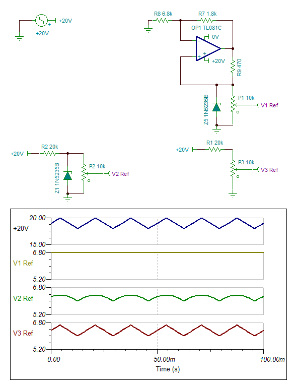

Stage two ...
I agree the op amp, zener diode, and voltage divider looks unusual. I did a comparison of three simple voltage references. For exaggeration purposes, I had the 20V supply exhibit a 2 Volt pk-pk 60 Hz sawtooth (ripple). The reason for the circuit is clear.
Very good point Joe.
This is relying on the power supply rejection of the op-amp, and giving a very useful improvement in circuit performance.
I have learned things here in this thread.
Joe, try matching the zener currents in your scenarios (e.g. reduce R2 to ~3.3k). I think you'll find that V1ref and V2ref are then better matched over the input voltage range. I'm seeing only ~5mV ripple on V2ref (which admittedly is absent in V1ref). The ripple reduces to 2.8mV if the supply voltage is derived via the Stage 1 stabiliser.
Alec,
I see what you mean. I only used the high ripple in the example to show an extreme as I was curious on why that topology was used.
That feedback scheme serves a useful purpose in stage three as well. Looks like it could be a very stable, precision, power supply.
All the negative comments about it being a half-wave rectifier appears to have been resolved.
