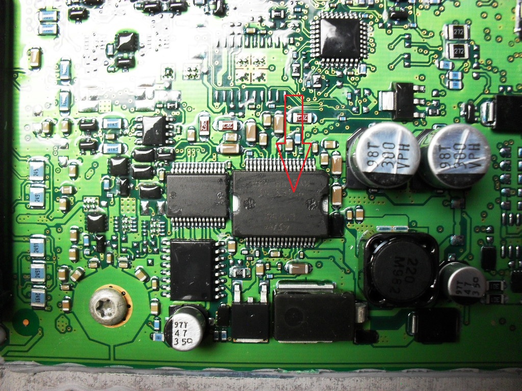

Trying to get a an SOIC chip off a board. So far this is not going well. I had to resort to running a wire under the pins and desoldering each and pulling them up. I certainly messed it up but toast anyway. Now I am realizing the heat pad in the middle is solder too! I cannot get to the back of the board.
I do have a desolder station and hot air equipment. I applied 300C hot air to the chip for several minutes and only succeeded in heatin the whole board up. What technique do I need? There are little exposed feet on the sides of the chip but my iron cannot pump enough watts in there to do any good. I think it is 40w.

OK, here's a bottom view of the chip showing the solder pad that has exposed tabs:
I would not use hot air, as that is not localized enough. I would use a high wattage iron with a wide tip directly on the chip or on both exposed ends. Melted solder on the tip will help. If you have some bismuth solder (very low melting), applying that to the end while heating may give enough of a lower-melting-point alloy right under the chip to help. ChipQuik (https://www.chipquik.com/store/ ) sells the stuff, and so do other sources. When you re-solder it, you may want to consider using bismuth-containing solder for that area.

^^^ yep! Pins are already off. No choice but to destroy them without a very specialize device. I did put the bead of solder on the sides and realized it was not going to work. I only hope I did not screw up the pads.... I should have just cut the pins and focused on the heat sink. The sink pretty much makes the chip nearly impossible to remove without damage.
A piece of heavy copper (>12 AWG) bent in a U and placed over the chip may help conduct heat to both tabs. Then use a really high wattage (like my 80W) iron to heat it. Although, I think that size iron directly on the chip back may also work and be simpler.

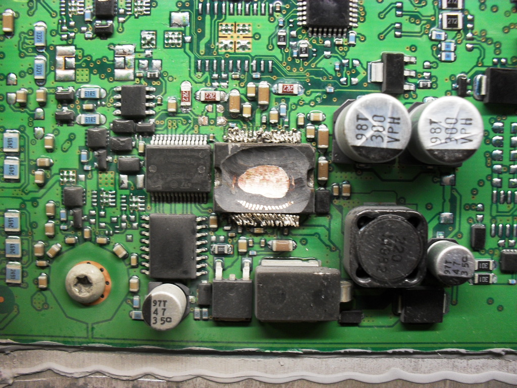

Resorted to this now.... Even pumping 150w into the sink, I cannot get it hot enough. Going to chase down a pencil torch now. This seems like flame heat territory. I don't know what is on the bottom of the board so preheating the entire board is probably not a good idea.

I put a huge ball of solder on the gun, then put on the heat sink. While on the sink, the solder even touching the gun would not stay molten.
I can still control heat reasonably with a small torch. I plan to shield the rest of the board. Check in shortly.
Again, there is no way to preheat this unit. There components on the back or bottom and I cannot even get the board out of its Aluminum case. The thing was never meant to be serviced. If something comes loose on the bottom, I am up a creek bu the way I see it, it has to be done to do the repair so all I can do is try. Because there are so many components close to the chip (some resistors are .010" wide and only about .020" from the feet of the chip), my options are rather limited. Grinding it out at least got me right to the sink to apply heat.
