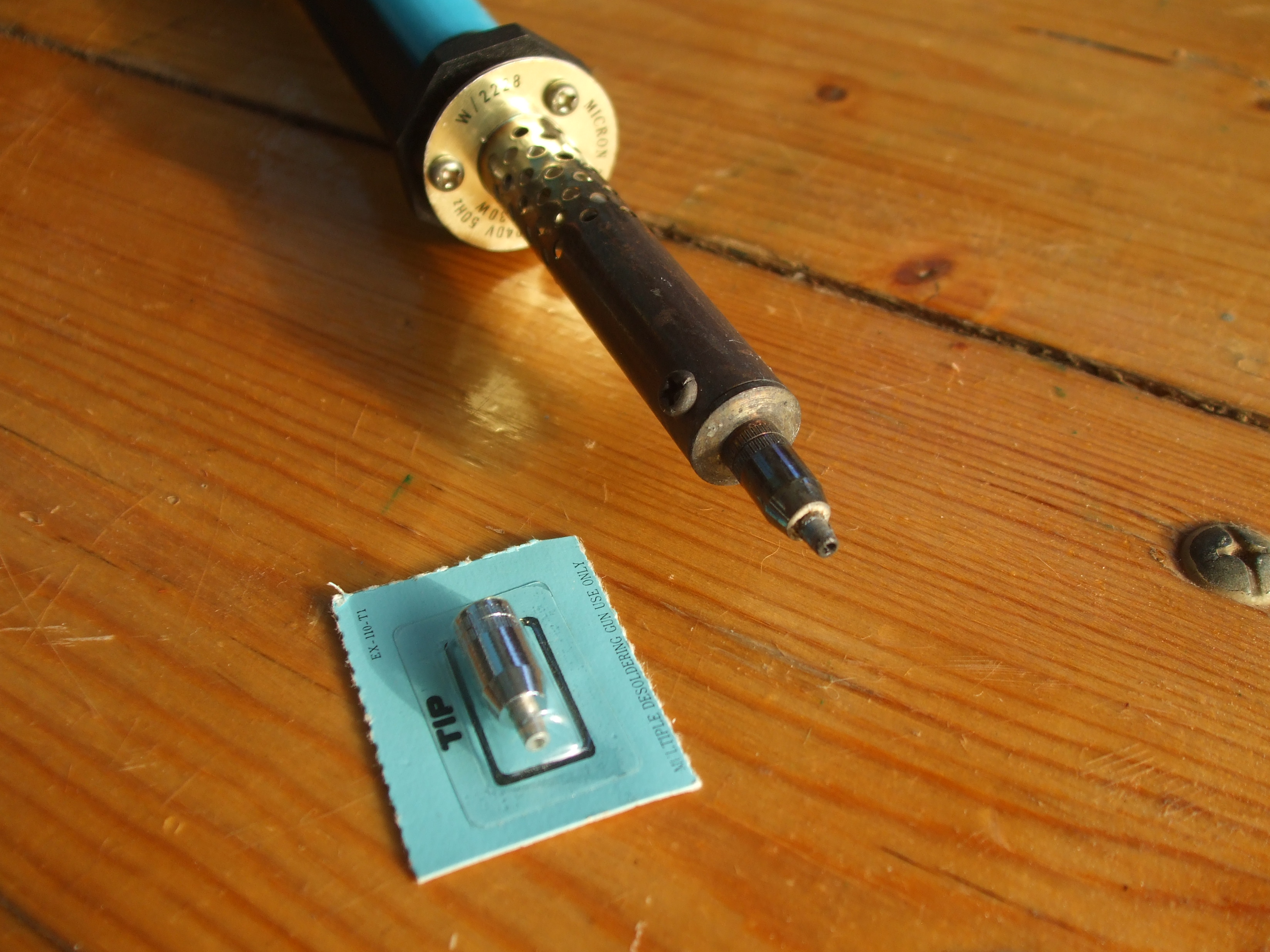

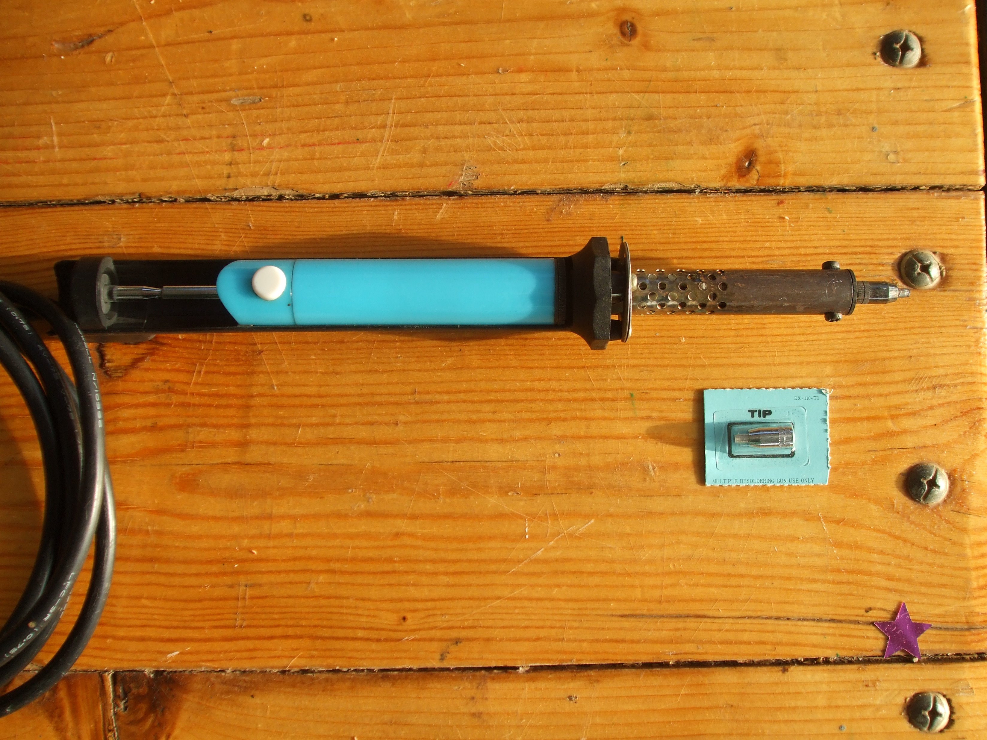

This is my old & still used desoldering tool. To get this into perspective Ive been soldering for nearly 50Yrs 25 yrs ago i did a crash course in Hi reliability soldering & desoldering. The main part of this course was mutch practice desoldering components from old computer boards with a mixture of plated through hole components. The trick was time required to melt the solder from one side of the board to the other, before trigering the vac. This is where i sugest you start with a few hours of practice. If you dont master this first it wont matter wheather you have a cheep or expensive desoldering station, the results will be the same. Practice & more practice. Ive found if your any good the simple iron should work. As for coroded tips Ive only replaced one on mine, still get another 4 spares. Daryl
