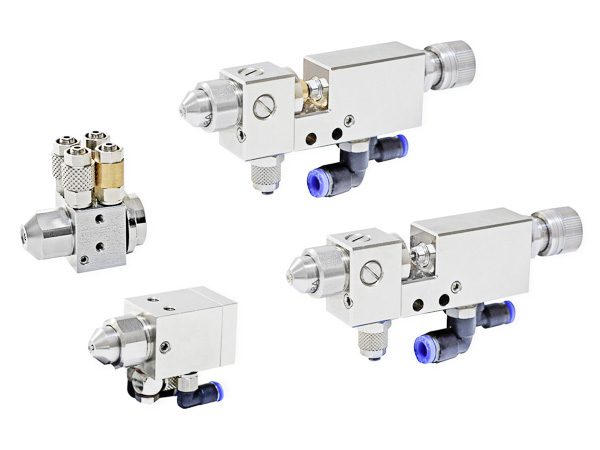

Maybe something like these?

Does it have to be paint? Would ink work? How about a single color jet from an old ink jet printer?
Or a bump from a Sharpie or a Paint Pen.
I was thinking of having something like a typewriter ribbon between the solenoid and the work piece.
