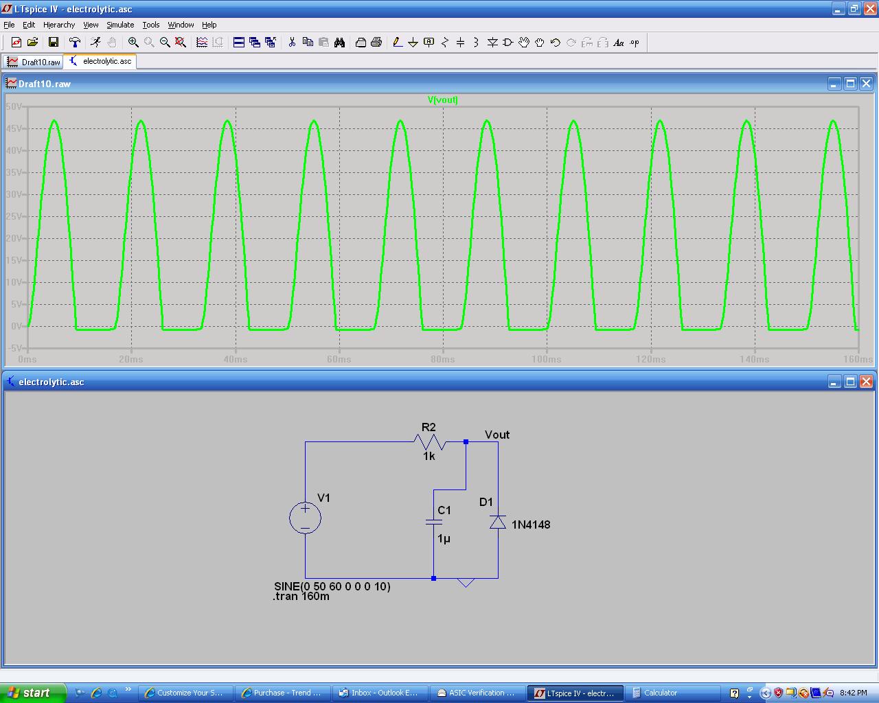

Here you go.
Ummm.. <cough> The diode is rectifying not the cap.
You're starting to actually model the electrolytic caps in reverse which DOES NOT OCCUR with the electrolytic cap model by itself. Because there ISN'T one. It's a schematic change not a model change.
Um, cough, the diode is part of the capacitor model. Try reading the data posted, as a smart member would do. As I said in the other thread, guessing doesn't cut the mustard.

1uF is far too low a value for AC coupling of 60Hz. Try running your sim at 10kHz and you'll find the 'rectifying' effect magically vanishes.:)
It doesn't disappear. The signal is attenuated due to the low impeadance of the capacitor, but it remains rectified. I showed it at 60hz because the rectification shows up better when the signal is not attenuated, but it remains rectified all the same.
"Special capacitors designed for AC operation are available, usually referred to as "non-polarized" or "NP" types. In these, full-thickness oxide layers are formed on both the aluminum foil strips prior to assembly. On the alternate halves of the AC cycles, one of the foil strips acts as a blocking diode, preventing reverse current from damaging
Wikipedia gets this wrong. I checked the references, and not one supports this. I'm satisfied that an actual capacitor manufacturer says it's OK to use two caps back-to-back. I had my doubts for a long time until I read the app note. All concerns have been addressed. The diode that appears in the model is real. No they don't insert a discreet diode inside the capacitor package, instead the diode is formed within the capacitor as part of the manufacturing process. It might be considered a parasitic diode, but it's real just the same. The other concerns about reverse voltage slowly breaking down the insulation have also been addressed. The reason electrolytic capacitors must be connected in the correct polarity is to prevent reverse voltage from damaging the dielectric through chemical reduction, but the back-to-back configuration prevents that from happening, because both capacitors see an alternating current, which neither reduces or reinforces the dielectric. In other words, the alternating voltage has no effect on the dielectric. This is all confirmed by the capacitor manufacturer. So go ahead and use this configuration. But remember, the manufacutrer states that both capacitors must be the same value.
