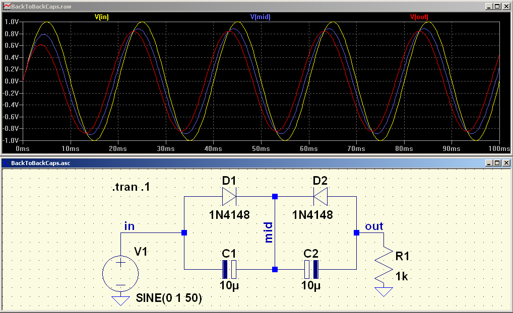

I'm afraid you've lost your bet :D. I did a sim as you said, with one of the caps replaced by a resistor. I also did a sim with back-to-back caps. The results were similar: no sign of rectification in either sim.
Not so fast. You won't see it in the back-to-back case, because each device rectifies different polarities, resulting in a re-constructed wave. Also, are C1 & C2 electrolytic models? And if so, are the diodes oriented correctly? I'll try a sim myslef at home. Can't do it right now.
