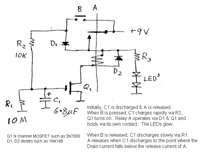

You could do it with a relay & a MOSFET. Then there would be no current when the relay was released and the LED out.
See attachment.
I did not bother to estimate what C1 should be to give a delay of 60 Sec.
But C1 = 6.8 :mu: F should be in the right area. If necessary, change it to another value.

Hey Len, thanks for the circuits! I think I might build both for the learning experiance. It looks like they both use some good principals.

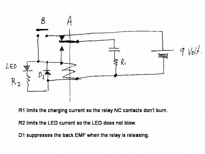

Hm, I have another idea- how about a 1F supercap (I love these things, they're hardly bigger than an M&M! They cost USD$2.50.) and a latching relay which disconnects the cap from the power supply and switches it to power the relay and LEDs?

There are 3 problems with your circuit.
  1. The NC contacts will burn due to the high charging current
  2. The LED will blow because there is no resistor to limit the current
  3. There needs to be a diode across the coil to limit the back EMF
And you don't need 2 pairs of contacts on the relay and the push button.
See attachment.
EDIT. I've drawn R1 in the wrong position. It would be better between the NC contact and the battery + terminal.

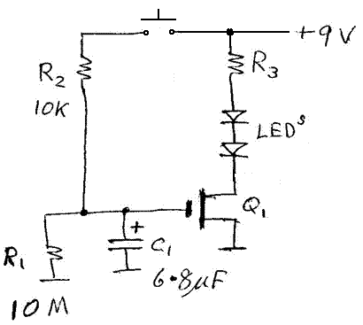

If you don't mind the LEDs slowly fading out, then this mod of Len's circuit is simpler:

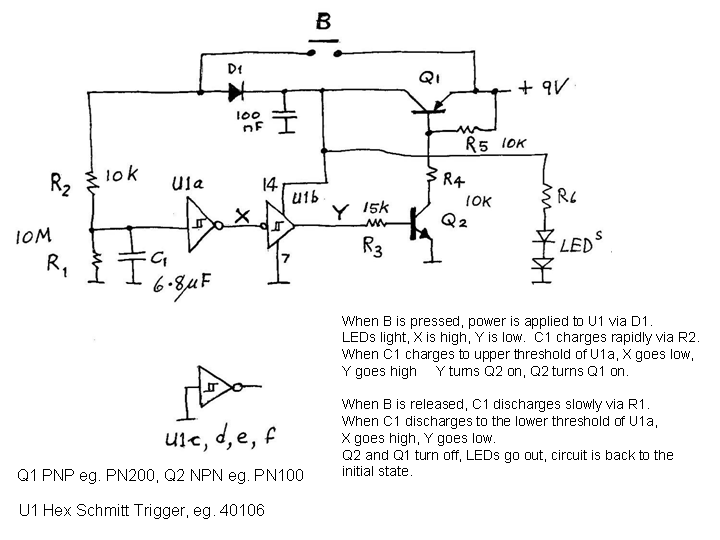

That was the point of the relay in the first and the Schmitt in the second - ie. to provide hystersis to prevent the LEDs fading slowly.
It also occured to me that the last circuit I posted suffers from the same problem. But it can be easily solved. Connect the LEDs to the NO contact of another contact on the relay and the common to +9V.
