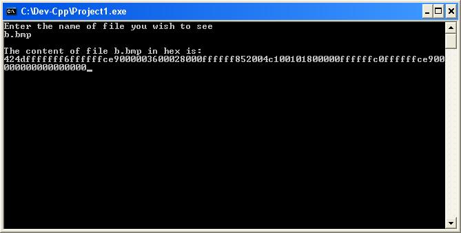

I came up with a simple code that reads bmp file (code is below and attached).
This is a 24-bit bmp file I created in MSPAINT (windows painter).
for some reason, I get the following reading:
i expected to get 0x424d.
But I don't understand why I get all these F's.
The file size is (642,806 bytes), meaning 0x09CEF6.
Shouldn't the reading outcome 0x09 0xCE 0xF6?

I just don't understand, how come when I read the bmp file via C code, I get different strange outcome.
Hi Ian,
Thank you.
I read the great link you provided.
I read the format the guy showed there, however, the problem is that when I read the BMP image (using the code I attached above), I get for example several F's (i.e. FFFF) between the File type. Set to "BM" and the Size in BYTES of the file.
I don't get what is the problem.
That is the reading I get:
But what I read was: 424dfffffff6ffffffce900000...
File size is not the same as image size. File size is image size + header.
EDIT: I tried to track those hex values and could not come to a sane conclusion (I got image width of 4294967173 pixels [0xffffff85]). Maybe there is padding so that all the values are 32 bits wide, but that is only a guess. According to the link Ian posted, the third field should be a "reserved word set to zero".. and in your output I can't see eight zeros at that place..
Yes, you're right, something might be wrong with the way I read.
Do you have a C Code that simply reads hex values of BMP image?
electro...Can you post the bitmap? I would like to see the hex file for myself
The other thing that maybe screwing it up... Are you reading the file size as a signed long?
0xFFFFFFF6 & 0xFFFFFCE9 seem like signed long's to me..
