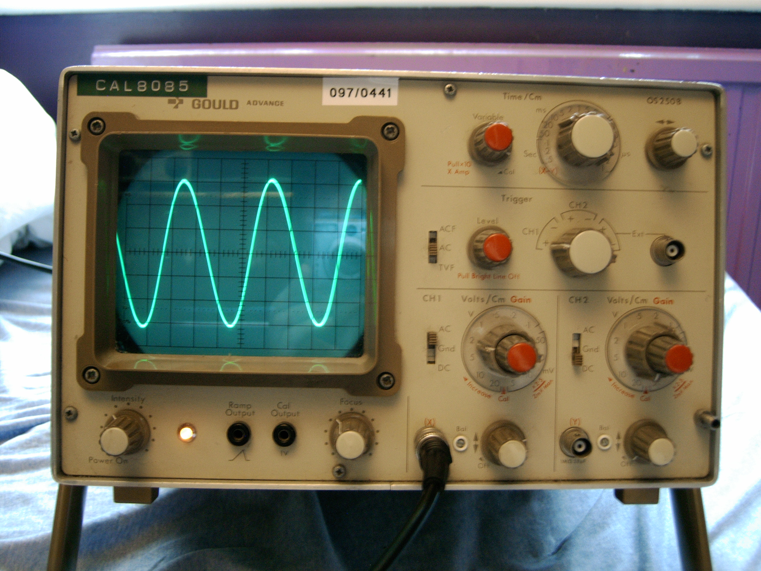

I've replaced the 250mA slow blow fuse, powered it up slowly using a variac and it works but it's behaving very strangely. When I turn the brightness down a bit it oscillates, the waveform flashes on and off at about 1Hz. When I turn the brightness up until it stops flashing, the waveform's amplitude changes slightly about once a second. It's also horribly off calibration (voltage wise). I set a signal generator to 50Hz sinewave so the oscilloscope read 16Vpp but the multimeter said it was 4.15V, it should read 5.66V - that's 26.5% out!
All of the controls work and both channels exhibit exactly the same behaviour. I haven't seen anything like this before; does anyone know what the problem might be?

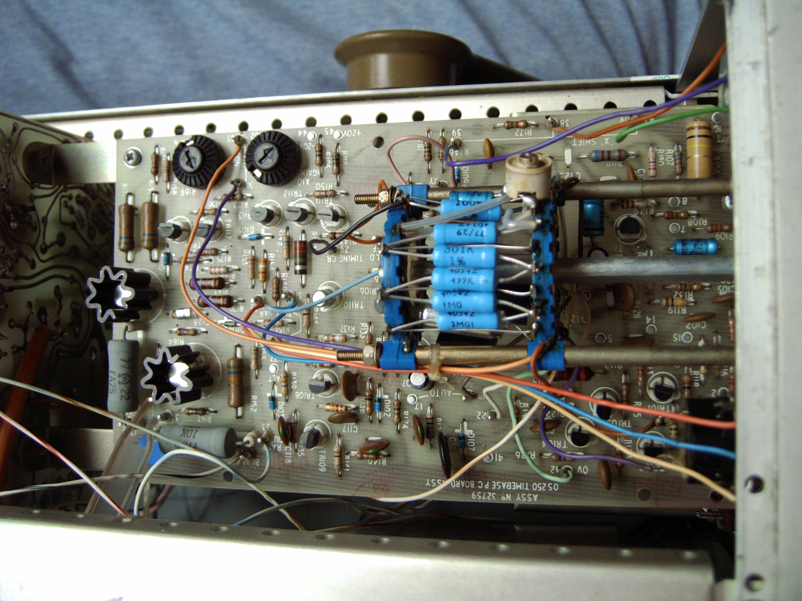

I switched it on to see if it still worked, the intensity oscillated as it had done before. I took the cover off and took a photograph of the circuit board. I replaced the cover, turned on the power and to my astonishment it had made a full recovery!

Here are some pictures, it's a great newb 'scope as it's simple and very easy to use, with not complicated features.

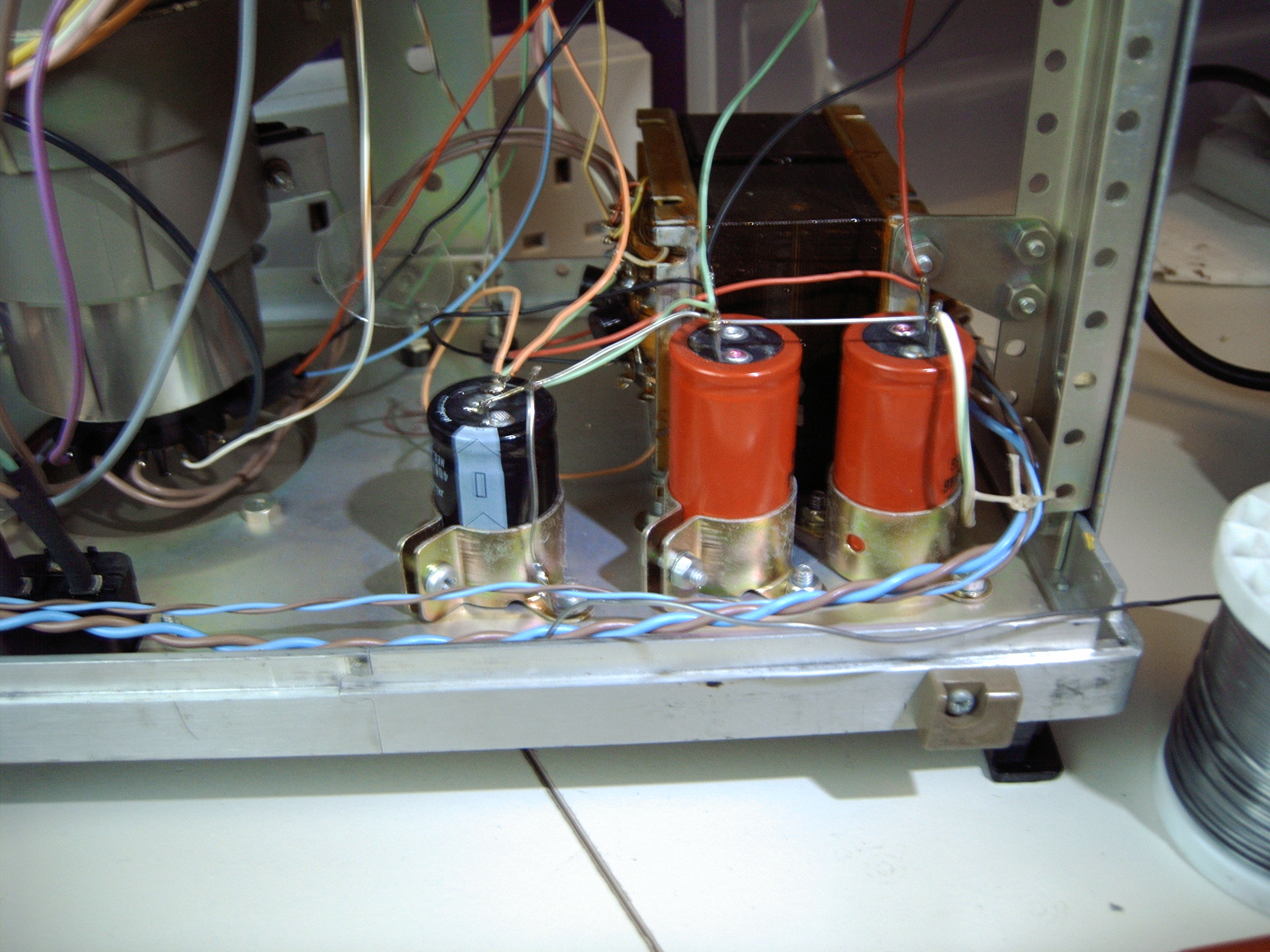

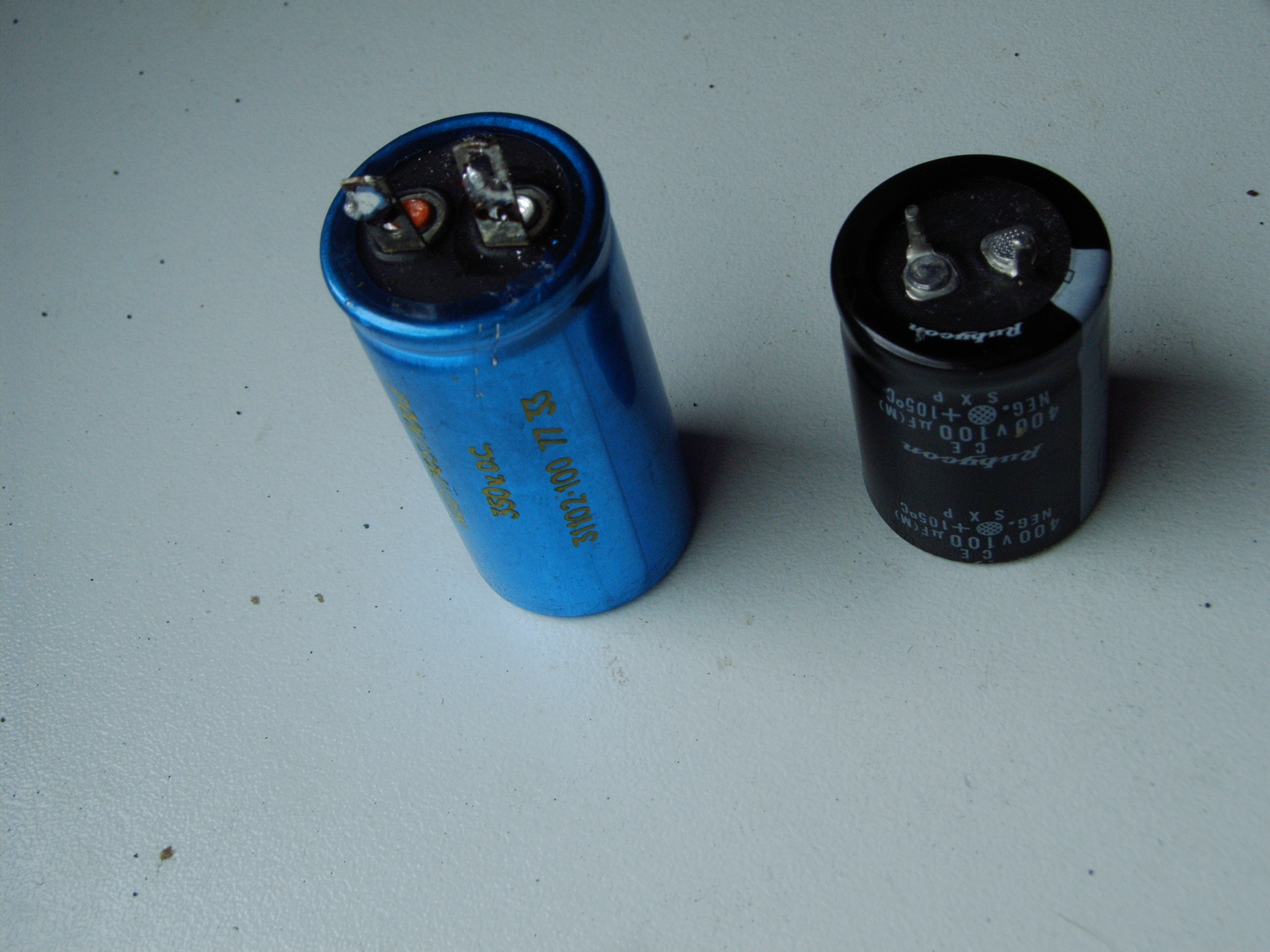

I took the bottom cover off; something I haven't done before. I noticed that a 350V 100µF capacitor had gone (the big blue one pictured in the attachment), the safety valve had blown and there was a small spot of gunge on it.
I replaced it with a Rubycon 400V 100µF 105°C capacitor from an old SMPs. The replacement capacitor is much smaller and the safety is on the other end so I left a small space between the capacitor and the case in case it blows.
I powered it up and the 'scope still works perfectly. I suspect the big red capacitors may have gone bad too so I'll replace them when I put my next Farnell/RS order in.
