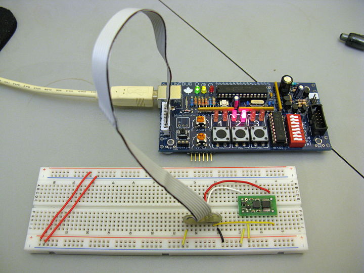

I got my **broken link removed** and have it wired up to the Junebug. Junebug is reading AN1, AN2 and AN3 and spitting out numbers to the UART tool. I have the 18F1320's AD in 8-bit mode, dropping the bottom 2 bits and am getting numbers in the range of approximately 68 to 103 decimal on each axis (1g gravity - I'm just tilting it). The actual voltages output by the accelerometer would be approximately 1.33V to 1.99V.
Now my newb question: I have the 18F1320 set to use the internal AVDD (5V) for a reference. If I set it for External VREF+ and feed RA3 with 3.3V from the regulator on the accelerometer, will I get a wider range of values in ADRESH? Or in other words, will I get better sensitivity?
Should I switch to 10-bit and rewrite my software?
This photo is slightly out of date. Had to add a power supply to the breadboard as the Junebug/PICkit2 can't supply VDD and do UART tool at the same time.
I got my DE-ACCM3D accelerometer and have it wired up to the Junebug. Junebug is reading AN1, AN2 and AN3 and spitting out numbers to the UART tool.

It does. Thank you for the comments and calculations.
I did some reading of the datasheet too, and calculated that at -3g the output voltage will be .66V and at 3g it will be 2.66V (it's a 3g accelerometer). It's already op amp buffered - not just a bare accelerometer chip. It looks to me like just doing a 3.3V ref voltage will give me the kind of results I want without extra circuitry.
So at 3.3V VREF+ I should see approximately:
-3g = .66V = 51
-1g = 1.33V = 103
0g = 1.66V = 128
1g = 1.99V = 154
3g = 2.66V = 206
I'll try it today and see.
The DE-ACCM3D datasheet.
Hey Blueroom Bill! If you're reading this thread, why does AN4 have a pullup?
I moved my Z axis to AN4 (so I could feed AN3 with a 3.3V reference) and it won't work. I'm pretty sure it's because of that pullup. The accelerometer is fine and the cable is fine. I moved wires around to test all that.
Anyway, giving the AD a 3.3V reference worked as I predicted. Full range (-3g to +3g) gives me a ADRESH value swing from approx 51 to 206. Quite useable. :D

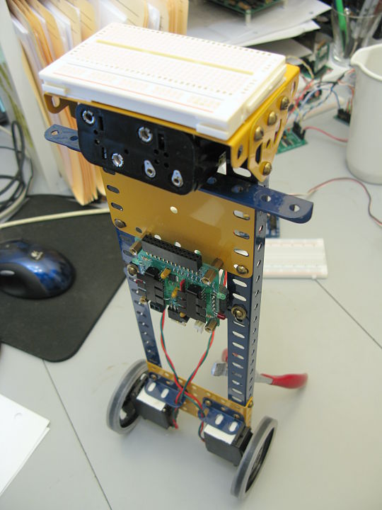

What I'm moving gradually toward is a balancing robot, so I'll really only need one axis. I know everyone says you can't do it without a gyro because the oscillations feed back and the thing falls down, but I'm going to try anyway. I can't believe you can't write some smart software that compensates and damps things.
Any robot I build will be very unlikely to be carrying my Junebug anyway. I'd probably either build a pic-proto type board for it or just use a solderless breadboard for easy changes.
And I think that proper accelerometer location on the bot could go a long way towards making it more stable. I figure that if I locate it at the "CG", or midpoint, the accel won't feel the g-forces as much and won't oscillate so hard. Watch me be dead wrong. :p
And if I fail I'll learn something anyway, and I'll have the chassis all ready to add a gyro onto. :p

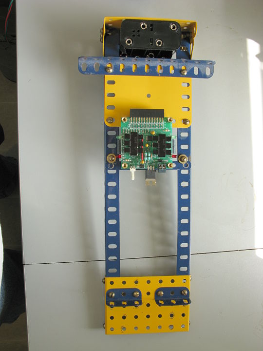

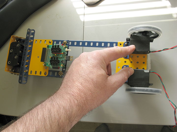

A few months ago I caught a guy on his way to the street to put his ancient Meccano set in the garbage. Saved it and now it's my balancer chassis.
