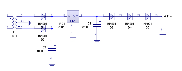

Just add 3 1n4007 diodes to the output (0.7 volt drop each) in series, solve the issue..but now the guy that need this info dont reply!!
Why not just use a 3V regulator in the first place?
Those diodes are going to totally ruin the regulation.
The diodes will not ruin any regulation, 7805 will all the time have 5 volts in the output pin, the diodes are a easy way to solve the issue,the only thing can affect diodes is temperature, it cause to them to drop more or less than 0.7 volts... i will use 7805 as variable regulator but seems to nobody undertand voltage divisor in the ref pin of the 7805 and not honoring thevenin and norton theorems....a real good one will be to use a 2n3054 to drive the power and a zener for reference, but this guy is learning, and we cant get in to very complicated solutions....

The voltage drop across the diodes will vary with the current through them, and for a small current will hardly drop any voltage at all - regulation will be terrible!.
As for using the 7805 as a variable regulator, I'm sure almost everyone here knows perfectly well how to do it, and that it's not a very good option - for a start the current limiting no longer works!.

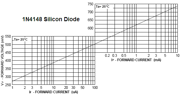

The datasheet for any diode shows how much its forward voltage changes with changes in the current through it. From 0.25V at low current to 2V at high current. it is logarithmic.
The change in voltage ruins the voltage regulation if it is in series with the output of a regulator IC.

Did you realise that are milivolts? any way, again, i am giving a "get out of the problem" solution , I am not posting to try to help somebody that dont know much, of course is not the high tech solution..i suject the 2n3054 with a zener, but this guy burned a zener before, so bad idea, I sugested the lm317 and he only have a 7805, I sugested the voltage divisor in the ref pin of the 7805 to make the output varible, I even posted the formula to calculate it..but only I get post reply to say...diodes dont work...7805 cant get variable output, etc..I dont care, please , help the guy asking for help...and please, be wise...if you know thah you dont know everything you will progress in life, if you thing you seen all, know all, then you are gone, and not posthing , because the millions you made will have you in the bahamas with 10 girls arround...I am wrong?

There's no point posting suggestions that are completely rubbish and won't work, your diode suggestion, although crude, would work under certain specific circumstances - but would be badly regulated, and would output near 5V under very low load. The variable 7805 idea is absolutely useless - you can only INCREASE the voltage with that, your example allowing adjustment between 5V and 10V (assuming you could get 10V with the input voltage you put on the diagram).
Your best idea was a discrete zener/transistor regulator - the reason the OP 'burned' a zener is probably because he simply stuck it directly across the output!.

Thanks jemch72,
After testing your advice I got the result which you will see it as an attachment file. But I need 3v from 5v regulator which is still elusive to me. I hope you will give me some light.
My components details :
Transformer - 9-0-9 Centre Type (From 220v AC)
Diode - IN4001
Capacitor(1) - 2200uf/25v
Capacitor(2) - 1000uf/35v
Regulator - LM7805
