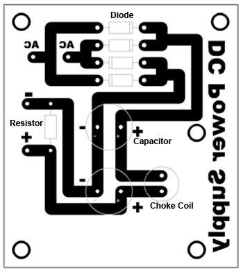

Dear Friend,
I have design a DC Power Supply (Bridge Type) for my audio amplifier. Please check my PCB design as an attachment file and tell me how I can make more smooth DC supply. Also tell me whether my design is right or wrong and give me some light on it.

That's a pretty basic power supply, completly unregulated. To get the output as smooth as possible use the largest electrolytic capacitors you can fit on the board that work at the rated voltage. What kind of voltage's / currents are you working with? You may be able to just tack on a linear regulator to give you regulated output which will make your amp much happier.

I like to use 2200uf/ 63v capacitor and I have also in mind that how I can get 3volt dc from LM7805 regulator from this pcb. Can you give me some light ?
You really need to provide more information on what you're trying to do. You still haven't said what voltage the AC in is, or where that AC is coming from, or any idea of what kind of output voltage you want except the 3volt DC, which is not possible because the 7805 is a fixed 5 volt regulator.

As I have already try zener diode but failed. It get very quickly hot and burn. Have resistor any role in this matter ? I will try your advice !

I am giving you circuit diagram of power supply. So check it and give your views on it !

C2 is too large, it should be around 100nF to 1:mu:F.
What's the output voltage from T1?
What's its current rating?
For 1A it should be at least 7V-0-7V, but you might be able to get away with 6V-0-6V for smaller currents though.
You still haven't said what current your circuit draws?
C2 is a way to high, it should be in the place of C1, and C2 value must be 0.1 uf,you will take more advantage of the power transformer if you use full wave rectifier, instead of half wave...and if you need the 3 volts from the 7805 you can put in series to the pin 1 (out) 3 diodes to make each drop 0.7 volts, or make a voltage divisor on pin 2 (ref)it means disconect ref from ground, put a resistor to ground and other to the output and in the middle the ref pin...if you put 2 equal value resitors, you will get 2.5 volts, play with them, we cant tell you the entire trick! go to :
The circuit diagram posted showed a full wave rectifier. A centre tapped transformer with two diodes forms a full wave rectifier.
center tap
You are right, I didn't see the ground in the middle, any way, the thing is to get 3 volts from 7805, so i am sorry to not see the center tap in the diagram,...
You can't get 3V from a 7805, you would have to add an extra regulator after it - so may as well not use the 7805 in the first place.
