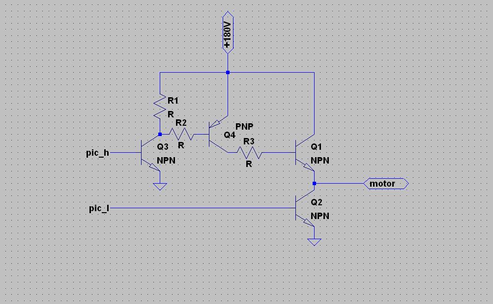

i am using a H-bridge circuit to rotate the motor in both directions.i want to know,whether the H-bridge circuit is capable of withstanding upto 180vdc.
can i directly connect the h-bridge circuit to 180vdc with the power drive i have....
if it doesn't then what is the solution.....
for starters, use transistors rated at 200-250V, and use anti-kickback diodes across them. a motor is an inductive load and can cause huge reverse voltages across transistors when you turn them off. is this a brushless motor?, how much current? is it a stepper motor? as blueroom said, got a schematic? are you looking for constant torque or speed?

it is a dc motor ... but i ve to change its direction after every 1.75 seconds.
a normal h - bridge can do this for a dc motor operating at 12v dc.
but my problem is that the dc motor which i ve operates at 180v.
and if i use that in the h-bridge circuit the transistors can be damaged ... as the h-bridge circuit is for small voltages.

For the H-bridge, you may use power MOSFETS such as the IXFX90N30 (available from Digi-Key...) 90 Amperes @ 300 Volts

that H-bridge isn't going to work as shown for 180V. you are going to need some kind of level shifting for the top two transistors. the reason for this is, the top two transistors are emitter followers (common collector), and the voltage at the emitter when one of these is turned on is equal to the base voltage minus 0.7V. so if you turn it on with the PIC output of 5V, the emitter voltage will be 4.3V. enough to spin a 6V motor, but not a 180V motor.
the following circuit (rough draft) is one half of the h-bridge. the low side needs no changes, but you can see how the level shifting is done on the high side.
Actually you can dynamic brake with an H - Bridge just turn on either both top switching devices at the same time or both bottom ones at the same time.
